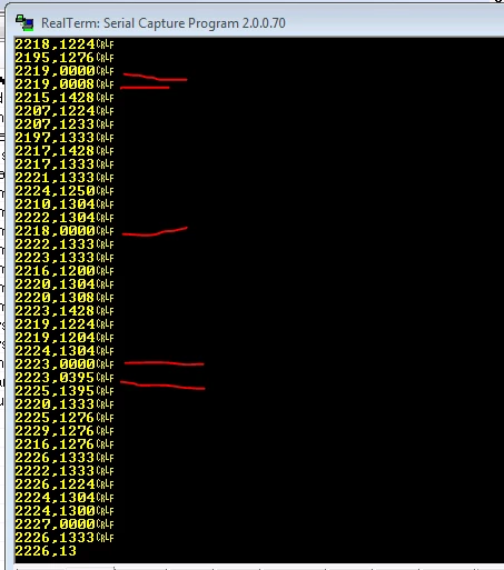

i am working on a application where i try to measure a motor speed and current,  and then send the data to the PC using serial uart.
The device used is a STM32F427
For controlling the motor i used a timer1 6pwm channels  triggered by timer2  hall xor event.
The motor runs with no problems.
For uart transition i use UART3  with DMA TX
- Timer2 CC1 IRQ event occurs at every change in the state of the 3 hall sensors, here i store the CNT value to the rpm variable.
- in the main program loop i check if a previously DMA transfer has ben made ( flag = 0?)
- if yes, then i  set the flag  , and read the current value and store to a  variable called current , and convert the data to string using sprintf in the following format    1234,5678\r\n (11 chars in lenght)
- after i converted the data, i enable the DMA USART TX request
- when the DMA TC completes, i copy the previously converted data to a temporary string buffer for sending out to the USART, afterwards the DMA TX is disabled
The problem i am facing is when displaying the data on the PC i get very often garbage data.
I have attached a small terminal data showing with red marking the garbage, and a simplified version of the code
How to overcome this?

    IMHO the DMA is perfectly doing its job. To make sure, replace rpm as sprintf argument with a dummy incrementing value, so you will easily sort out which of DMA or calculate_rpm() is wrong.

    regarding tmp[2]  ,  this is 1 char + space for NULL ,  it is  used to send one char on every dma transfer
    i have tried to use a fixed value for rpm in the sprintf function, it seems stable.
    After doing more debugging, i have moved most of the code inside the timer2 irq handler,   now my DMA irq code looks like this
    The DMA now works with the Buffer,  i have removed tmp
    The DMA when finishes the transfer, sets the flag to 0,    normaly when the CC1 IRQ is triggering again, it will check for that flag,  if the flag is reset, will process the new data, and prepare for a new DMA trigger,  if not it will move on with the rest of the tasks

    It seems my problem is in the timer2 irq handler.
    To sumarize my settings
    - timer2 has a input clock (PCLK)  of  50 MHZ
    - timer2 prescaler is set to 699  ( 700-1)
    -  period set to 65535-1
    - motor RPM  min 50,  max 5000
    so timer2 is ticking with a speed of  (1/50MHZ) * 699 = 13.98 uS
    It will overflow at 13.98us x 65534 , which is 0.91 seconds, seems long enough
    At low speed i should have a time between IRQ calls of  6.9 mS
    At high speed i should have a time between IRQ calls of 0.666 ms
    Who is storing the number of ticks? TIM2->CNT or TIM2->CCR1 ?
