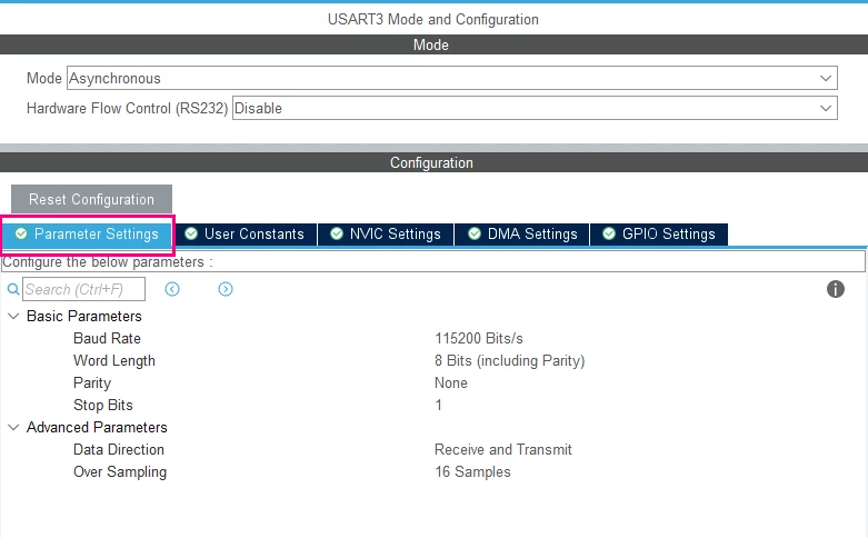

Hi All,
I am new in ST microcontrollers. I tried to get messages from the USART module of NucleoF429. i follow the steps in this article:
STM32StepByStep:Step3 Introduction to the UART - stm32mcu
I used many serial monitor tools such as TeraTerm but I could not get anything ..
I tried all the USART modules of F429, but I could not get anything.
Could you please help me ?
Thanks

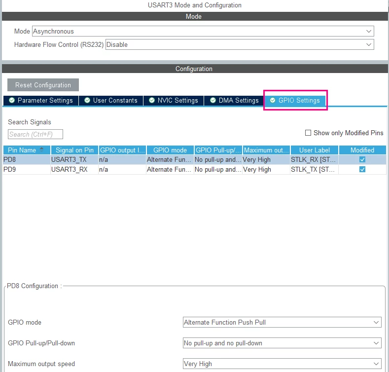

Hi @Hasan​  and welcome to the Community :),
Unlike the step by step tutorial, USART3 needs to be used for Nucleo-F429 (show the UM1974 and precisely section 6.9 USART communication).
I suggest you follow these steps:
  1. Create a new project using STM32CubeMx.
  2. Select Nucleo-F429ZI board using Board Selector.
  3. Answer Yes to Initialize all peripherals with their default mode ? popup.
  4. In Pinout view tab, check that USART3 mode is configured to Asynchronous, PD8 is connected to USART3_TX and PD9 is connected to USART3_RX.
  5. Click on USART3 button, select Parameter Settings and make sure the parameters as shown in the below figure.0693W00000QNhhNQAT.png
  6. Select GPIO Settings and make sure the configuration GPIO as shown in the below figure.0693W00000QNhhrQAD.png
