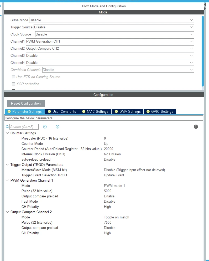

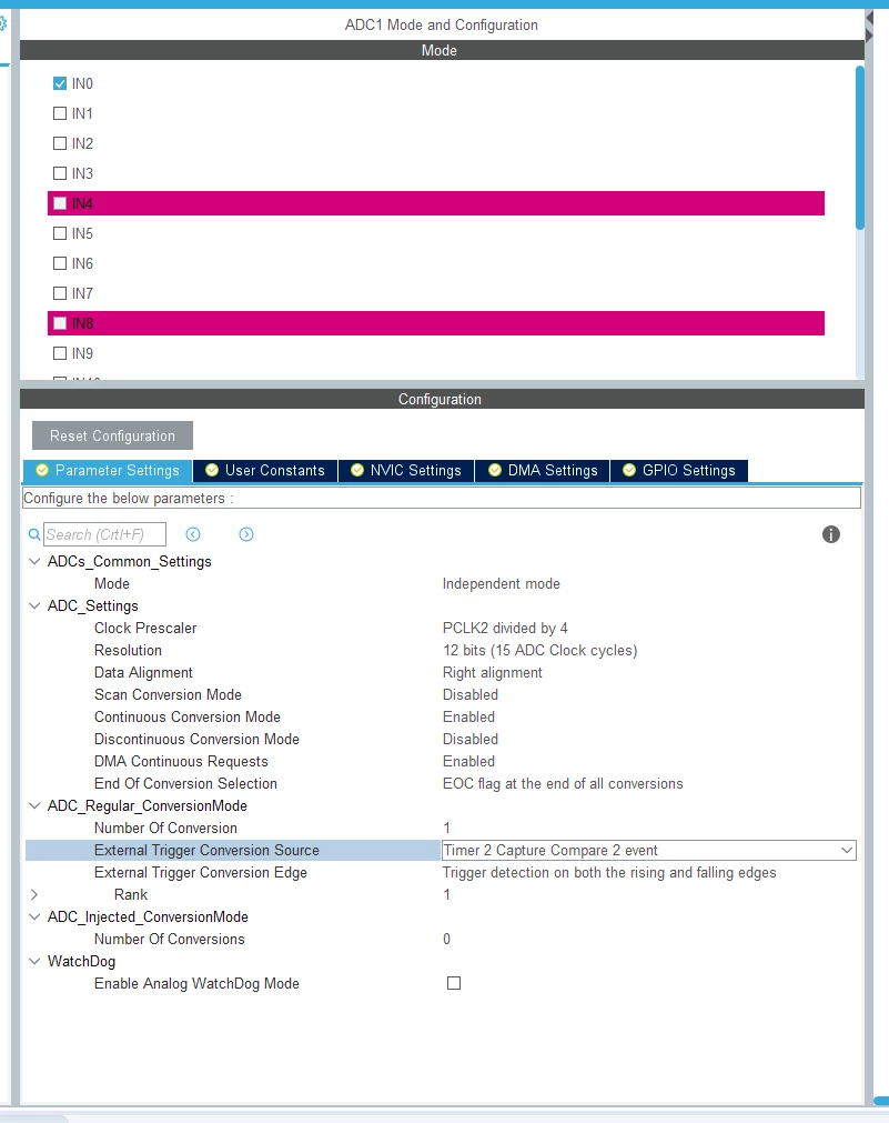

Anyway, I've got a PWM output from TIM2 CH1 (200us perioud, 25% D.C.) and I have another PWM from TIM2 CH2 with 35% Duty Cycle (now currently set to OC mode but toggles at the same time). I want to enable the ADC through DMA to capture 50 samples from the falling edge of TIM2 CH2. The ADC is set up to be 1.8Msps. According to RM0410 Rev 4. 439/1954 I can indeed use TIM2 CH2 as an external trigger, but my question is how? I previously got this working just using interrupts and then enabling the ADC in the HAL_TIM_PWM_PulseFinishedCallback after checking the correct timer and channel source, but this took way too long and used up the CPU more than I wanted. I've made multiple attempts at solving this but my latest has been this:
Start ADC DMA in the main, enable the ADC external conversion source as Timer 2 CC2 event and then the trigger event selection TRGO as "Update Event"
I start DMA in the main:
int main(void)

static void MX_ADC1_Init(void)
 /* USER CODE BEGIN ADC1_Init 0 */
 /* USER CODE END ADC1_Init 0 */
 ADC_ChannelConfTypeDef sConfig = {0};
 /* USER CODE BEGIN ADC1_Init 1 */
 /* USER CODE END ADC1_Init 1 */
 /** Configure the global features of the ADC (Clock, Resolution, Data Alignment and number of conversion)
 hadc1.Instance = ADC1;
 hadc1.Init.ClockPrescaler = ADC_CLOCK_SYNC_PCLK_DIV4;
 hadc1.Init.Resolution = ADC_RESOLUTION_12B;
 hadc1.Init.ScanConvMode = ADC_SCAN_DISABLE;
 hadc1.Init.ContinuousConvMode = ENABLE;
 hadc1.Init.DiscontinuousConvMode = DISABLE;
 hadc1.Init.ExternalTrigConvEdge = ADC_EXTERNALTRIGCONVEDGE_RISINGFALLING;
 hadc1.Init.ExternalTrigConv = ADC_EXTERNALTRIGCONV_T2_CC2;
 hadc1.Init.DataAlign = ADC_DATAALIGN_RIGHT;
 hadc1.Init.NbrOfConversion = 1;
 hadc1.Init.DMAContinuousRequests = ENABLE;
 hadc1.Init.EOCSelection = ADC_EOC_SEQ_CONV;
 if (HAL_ADC_Init(&hadc1) != HAL_OK)
 Error_Handler();
 /** Configure for the selected ADC regular channel its corresponding rank in the sequencer and its sample time.
 sConfig.Channel = ADC_CHANNEL_0;
 sConfig.Rank = ADC_REGULAR_RANK_1;
 sConfig.SamplingTime = ADC_SAMPLETIME_3CYCLES;
 if (HAL_ADC_ConfigChannel(&hadc1, &sConfig) != HAL_OK)
 Error_Handler();
 /* USER CODE BEGIN ADC1_Init 2 */
 /* USER CODE END ADC1_Init 2 */

 htim2.Instance = TIM2;
 htim2.Init.Prescaler = 0;
 htim2.Init.CounterMode = TIM_COUNTERMODE_UP;
 htim2.Init.Period = 20000;
 htim2.Init.ClockDivision = TIM_CLOCKDIVISION_DIV1;
 htim2.Init.AutoReloadPreload = TIM_AUTORELOAD_PRELOAD_DISABLE;
 if (HAL_TIM_PWM_Init(&htim2) != HAL_OK)
 Error_Handler();
 if (HAL_TIM_OC_Init(&htim2) != HAL_OK)
 Error_Handler();
 sMasterConfig.MasterOutputTrigger = TIM_TRGO_UPDATE;
 sMasterConfig.MasterSlaveMode = TIM_MASTERSLAVEMODE_DISABLE;
 if (HAL_TIMEx_MasterConfigSynchronization(&htim2, &sMasterConfig) != HAL_OK)
 Error_Handler();
 sConfigOC.OCMode = TIM_OCMODE_PWM1;
 sConfigOC.Pulse = 5000;
 sConfigOC.OCPolarity = TIM_OCPOLARITY_HIGH;
 sConfigOC.OCFastMode = TIM_OCFAST_DISABLE;
 if (HAL_TIM_PWM_ConfigChannel(&htim2, &sConfigOC, TIM_CHANNEL_1) != HAL_OK)
 Error_Handler();
 sConfigOC.OCMode = TIM_OCMODE_TOGGLE;
 sConfigOC.Pulse = 7500;
 if (HAL_TIM_OC_ConfigChannel(&htim2, &sConfigOC, TIM_CHANNEL_2) != HAL_OK)
 Error_Handler();
 /* USER CODE BEGIN TIM2_Init 2 */
 /* USER CODE END TIM2_Init 2 */
 HAL_TIM_MspPostInit(&htim2);

if you can, use physical pins between timer and adc. it is not clear what event causes the burst of acquisitions. maybe you cab cook a non cyclic dma of 50 toggles on ch2 if your stm32 supports it?

It is definitely possible according to the reference manual. You can try setting the EXTSEL field in ADC->CR2 either to TIM2 CH2 or TIM2 TRGO and set the master mode field in TIM2->CR2 to OC2REF. To get a trigger on the falling edge, use the other PWM mode and invert the channel output polarity.
