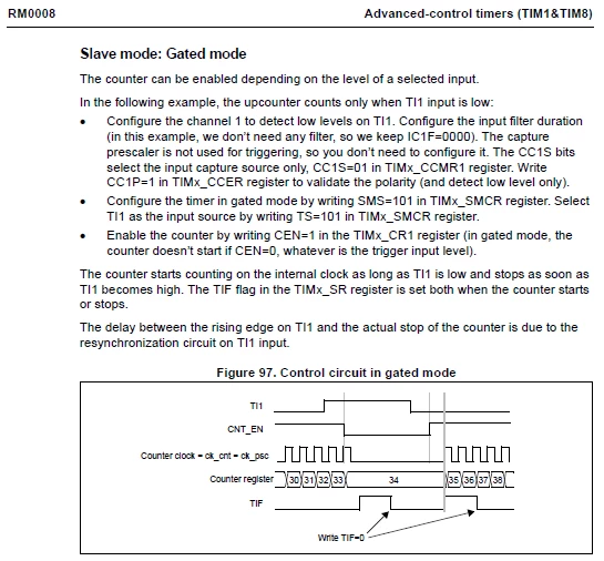

hi
i need start timer with external pulse at falling edge at one pin
and i need stop timer
can convert two 16 bit timer to one 32 bit timer ?
on stm32f103c8t6
my timer clock is 72Mhz
what can i do ?
 thanks

Hello!
You may use the slave controller in gated mode and to use a InputCapture channel for triggering.
Rgrds
vf

The start timer pin must be different with the pin timer
i most have 32 bit timer because my 16 bit is low for my timer
can i do it ?
