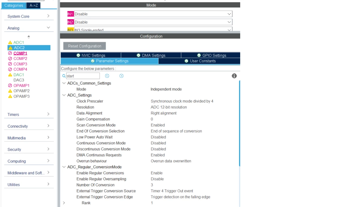

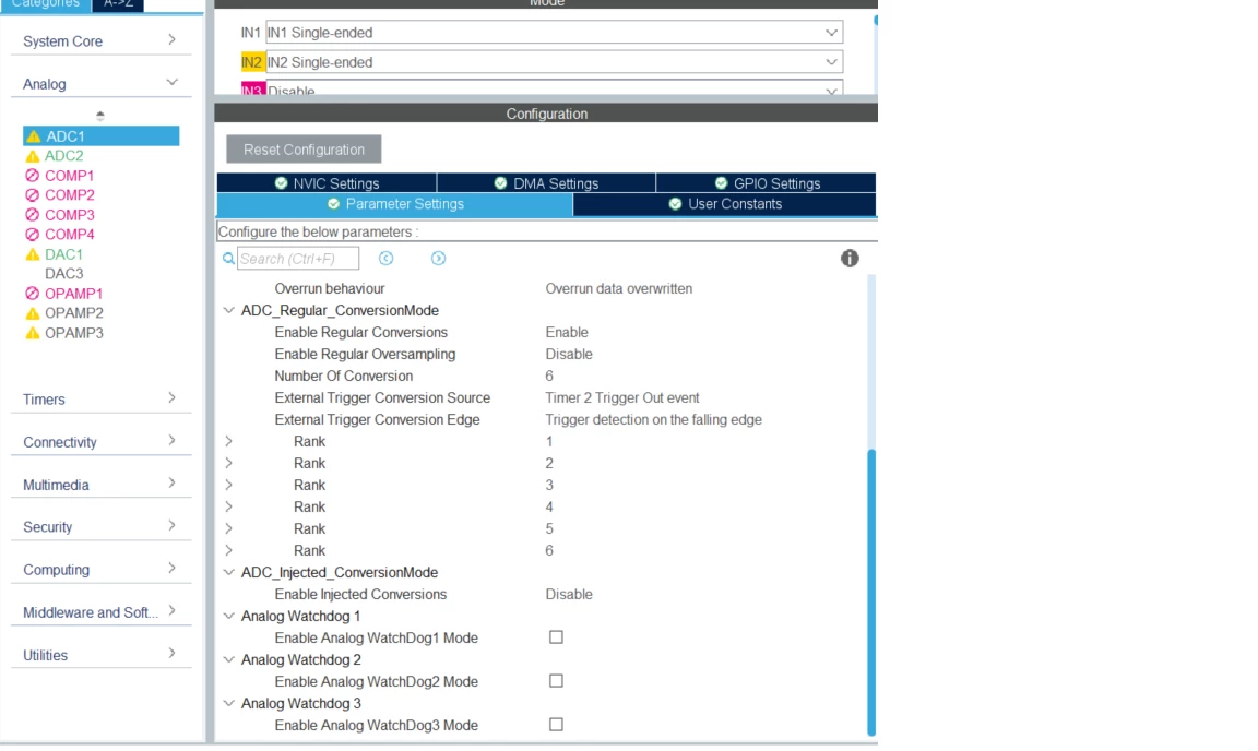

I want to have 2 ADC interrupts with DMA. ADC1 is triggered using TIM1 at 4kHz, while ADC2 is triggered using TIM4 at 74kHz. Two different timers are used for different ADC to have different sampling time. The ADC2 is set as Medium priority while the ADC1 is at low priority.
Questions are as below:
1. If more lines are added in "hadc==&hadc2" then it changes the ADC2 interrupt frequency from 74kHz to lower values. I did not understand why ?
2. How to confirm the conversion + sampling time for each ADCs ?
3. There is another timer interrupt triggered at 4 kHz, how to understand the priorities of all 3 Interrupts (ADC1(TIM2), ADC2(TIM4), TIM1) with respect to each other ?

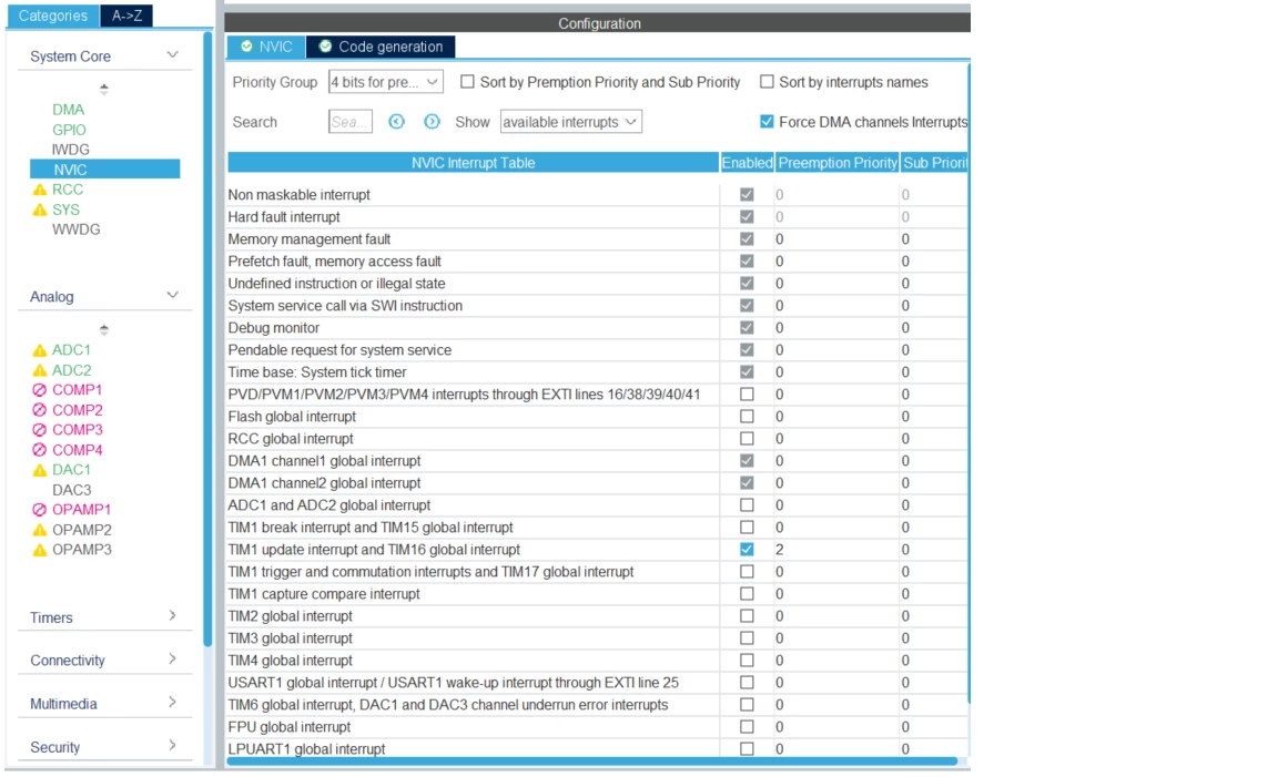

Interrupts are independent. Highest priority wins. Typically they can pre-empt each other but it can be configured differently.

I am using
ADC1(TIM2) interrupt at 4kHz for the measurement,
ADC2(TIM4) for 2 control loops running at 20 and 10 kHz within TIM4 interrupt running at 74 kHz,
TIM1 interrupt for PWM and control loop running at 4kHz.
Please find attached screenshot of the ADC1, ADC2 and NVIC settings.
where can i set the priority of timer interrupt with respect to ADC interrupts ?

Interrupt priority is the "preemption priority" column in your screenshot. Numerically lower values are higher priority, 0 is the highest priority, 15 is the lowest priority.
