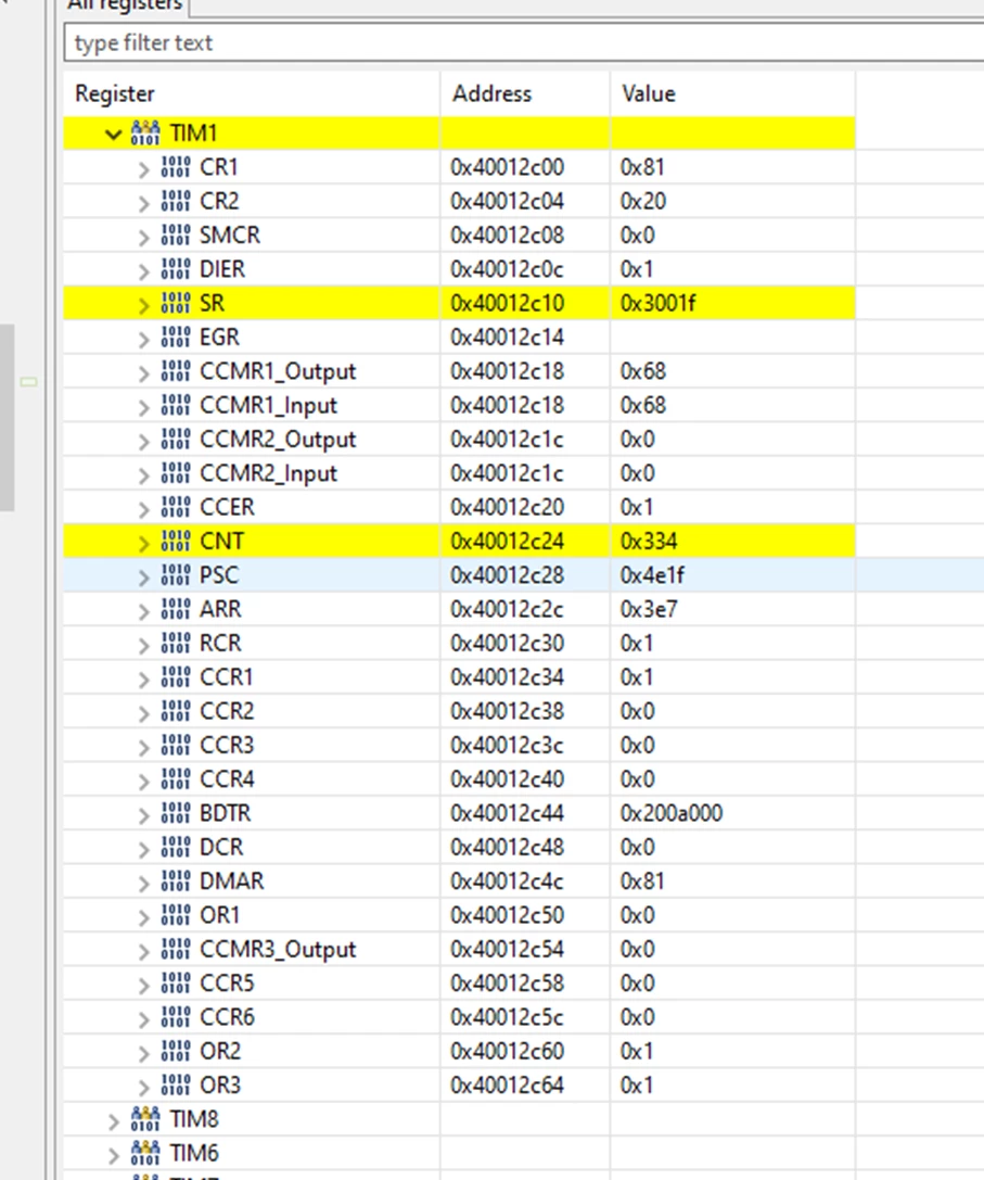

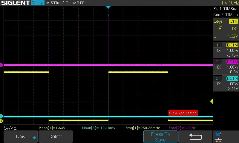

I am trying to Trigger timer 15 from timer 1....Yellow in scope pic shows timer 1 output to be used as gated trigger... I am trying to get PWM gated out of Timer 15....
Can anyone tell me what I am doing wrong in the code bcz I get no PWM out of PA2?

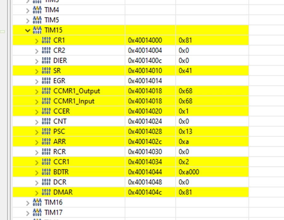

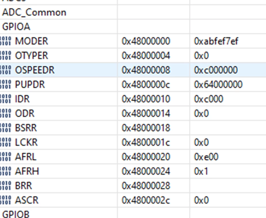

Read out and check/post both TIM and the relevant GPIO registers' content.

Timer15 registers:
Timer1 registers:
0693W00000Y7UdSQAV.pngPort A Timer15 output:

I don't see TIM15_SMCR. Is this from CubeIDE?

The main problem most likely is, that in TIM1 you've selected Update as TRGO source in TIM1_CR2.MMS. Update event is only one clock wide, so that generates a very short pulse on TRGO, you can't use that as source for Gate in TIM15.
You need to configure one of the channels in TIM1 as Compare (PWM), to generate a relatively wide pulse, and use that as TRGO.
(Btw. I also don't understand why did you set TIM1_RCR=1, but in this case it should be harmless).

Thank you for the response....The RCR is because ultimately I want a 20 minute delay per trigger event...I was testing the RCR portion as well....I will look into making PWM compare out as you said when I get the opportunity.....
