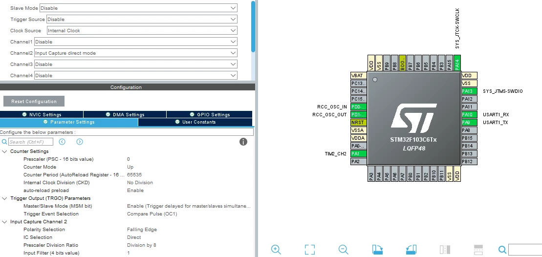

timer How to detect a signal I useSTM32CubeMX 6.6.1 and STM32CubeIDE 1.8.0 I'm using a microcontroller.stm32f103c6 I need a way to capture the signal. to calculate the speed of rotation Can someone give me some advice, thanks.

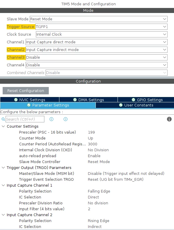

    timer can capture full hi/lo pulse , just see my IR-receiver input:
    0693W00000WIqQPQA1.pngi choose the timer5 clk+ prescaler, to get 1us tics; so on timer5 INT i get us count for hi and lo time of every incoming pulse.
    perfect... right?
