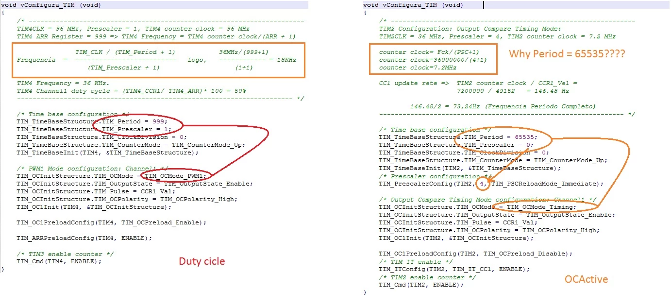

I would like to know why in TIM_OCMode_PWM1, I can calculate the frequency
'Duty cicle'
                        TIM_CLK / (TIM_Period + 1)                36MHz/(999+1)
 Frequencia  =  --------------------------------    Logo, ------------------ = 18KHz
                                (TIM_Prescaler + 1)                               (1+1)
(see attached file)
And in TIM_OCMode_Timing the period was set with 65535???? 'OCActive'
(see attached file)

    Because presumably using the maximal 16-bit counter value makes advancing the CCR at each CC interrupt profoundly easier to do, and doesn't require any modulo math using slow divide instructions. And issues with CC/Update interrupts.
    By advancing the CCR you can generate a far wider range of frequencies than you can with the integer divider methods.
