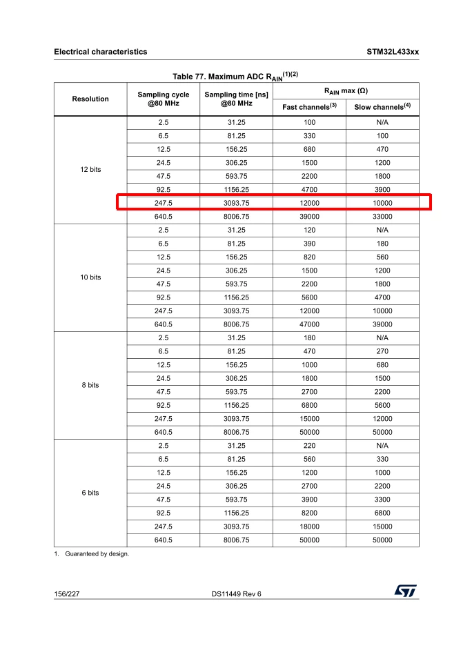

What's the impedance of the 1.026V source? Try increasing sampling time, see datasheet.

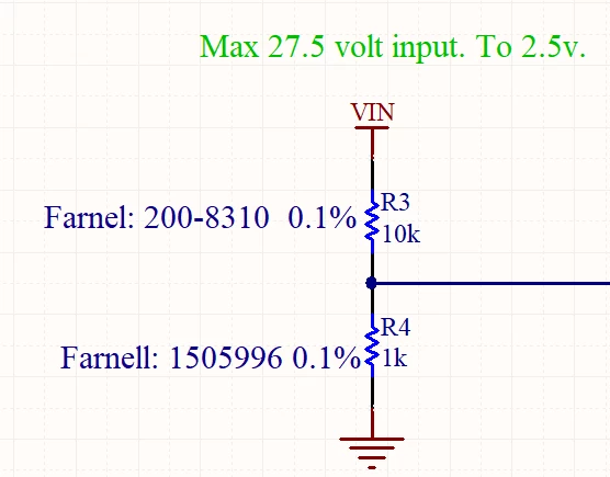

Im not great with impedance , but what I am trying to do is measure the input voltage. See below picture. The output of the divider goes right into the ADC. If I stuck it through an opamp as a buffer, would this improve it?
Cheers
Scott
waclawek.jan
March 26, 2023
The reason why input impedance matters is, that it has to fully charge the sampling capacitor during the sampling phase.
Opamp follower is never a bad idea, but if high input impedance and too short sampling time is the primary problem, it should be enough to increase the sampling time.

Thanks for the reply. As I was using the HAL (easier for testing), I set the sample rate to 247 and 640 , but still had the same result.

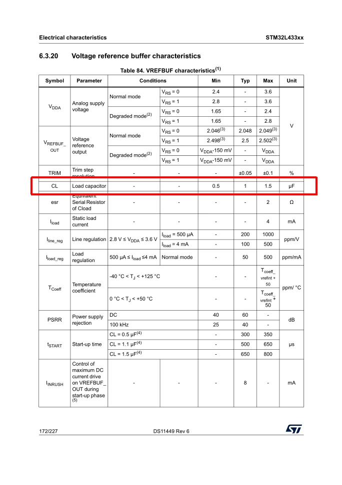

raptorhal2
Lead
March 26, 2023
See Section 3.17 in the data sheet.
The answer comes out real close if you are on the internal 2.048V reference buffer.
A resistor divider external buffer may need the Figure 5 capacitors to provide a clean reference. A 1.0 uF will probably be OK for the mystery capacitor.
waclawek.jan
March 26, 2023
Oh, it didn't occur to me that VREF+ is not connected to an external 2.5V reference, but is fed from the internal reference instead...
In that case, the "mystery capacitor" actually needs to have a relatively precise value (actually 1.0uF as said by @raptorhal2​  in parallel with the 100nF ceramics is just OK).

Sorry, I forgot to add the below to my picture above (see below). As per manual I have 100nf and 1uf to vref. As you see I already have a 1uf added.
