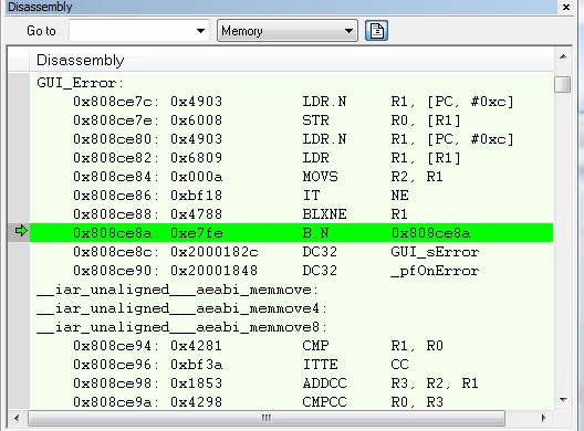

hello:
i used the STM32F439 control
#define GUI_NUMBYTES  (1024 * 1024*2)
/* 32 bit aligned memory area */
U32 extMem[GUI_NUMBYTES / 4];
void GUI_X_Config(void)
   GUI_ALLOC_AssignMemory(extMem, GUI_NUMBYTES);
In the SDRAM
//Changed here only
  static U32 *aMemory;
  aMemory=(U32*)0xc0000000;//as GUI's RAM buffer
 GUI_ALLOC_AssignMemory(aMemory, GUI_NUMBYTES);
If used the SDRAM as the GUI's RAM,I can't pass the GUI_DEVICE_CreateAndLink(DISPLAY_DRIVER_0, COLOR_CONVERSION_0, 0, 0);
I don't know why.
the driver of LCD is OK, The SDRAM_Init(void) ,
void SDRAM_InitSequence(void) used the demo.
the hardware is MB1046 ,if anyone have this demo board,you can try it.
In the end ,i don't know what's why .i used the SDRAM as GUI's RAM.
the software is IAR6.6 .
At the same time.i used the keil to debug the code .i found that it's can't jump to the c,always in the disassembly .it's strage.
thank you so muck.
best regards
Roy

    Don't know, but it looks like it's trying to generate an error, and jump to a user provided callback function to manage the error. I'd imagine that callback address is NULL, and thus not being called, and that R0 is some kind of ERROR CODE or context, which the callback could act upon.
    The registers at the loop would likely be quite telling.
    At a guess it might be reporting it can't READ/WRITE the memory region passed, or it exceeds some limits?

    Passes through a string error message sent to
    void GUI_Error(const char * s);
    void GUI_SetOnErrorFunc(void (* pFunc)(const char * s));
    http://www.segger.com/admin/uploads/productDocs/UM03001_emWin5.pdf

    i found a problem.i used the st-link download the code and debug ,it can't pass the GUI_Init(),however ,i used the J-link ,it can .i don't know  that's why .
    i have upgraded the firmware of the st-link.i don't know why?
    it's the dug of the st-link.or not?

    There is a bug with the Stlink code downloading. That's probably why it works for you using the Jlink, but does not if you use Stlink.
    To verify this, just simply do a verification with the J-Flash, after you downloaded your code with Stlink, you'll most likely will get a comparison error.

    Ok, again this thread is from *2013* and Roy was *not* using ST-LINK Utilities, he'd been using IAR and KEIL directly. And had problems with memory buffers, and checks emWin did against them.
    The errors with the ST-LINK Utilities .HEX parser, while interesting, don't impact most users where the debugger interfaces directly with ST-LINK. Everyone would be seeing problems, and that's simply not happening. The ST-LINK implementation is no where near as robust/industrial as the JLink, and it does a number of things differently which could explain issues short of gross ones where the memory is massively corrupted/shifted.
