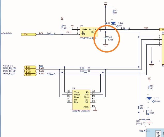

Hi everyone,
I'm a newbie with stm32f4Discovery kit, and I've just finished writing a code for implementing sending and receiving a character using USART, I'm using Keil uV5
Here is my code which is an example found on the web with some modification to suite stm32f407 microcontroller

I've compiled this code and it was compiled without any errors or warning..
now I want to find out if my code function properly or not
I've installed RealTerm and plugged in my Kit and burn the code on the microcontroller, but nothing happened or appeared on RealTerm
Notes: every time I open RealTerm application an error appears
''Error in GetComDevicesList opening registry key:...''
and I've no idea how to configure RealTerm to work well with Keil, stm32f4Discovery kit, and Windows 7??
so I'll be gratitude if anyone help
thanks a lot

    Posted on March 23, 2014 at 02:21
    You should NEVER exit main(), it goes nowhere, and will crash.
    You can't use PA9 on the STM32F4-DISCO, it connects to a huge bulk capacitor related to the USB interface. Review the manual and schematic.
    RealTerm needs to see a serial port, just plugging the board into a USB port does NOT achieve this.
    What you need to do is connect the USART TX/RX pins to a USB-to-CMOS Serial type converter board/cable. I'd recommend using USART6 and PC6,PC7.

    salahuddinash
    March 23, 2014
    Posted on March 23, 2014 at 04:55
    Thank you very much sir for your fast reply
    Here are some points I hope you kindly to indicate, I know they are too many but excuse me as I'm just a newbie trying to learn
    1-
    #include ''stm32f4_discovery.h''
    in your code, what is the stm32f4_discovery.h file is for? I looked for it in the standard peripheral library and the code example included with keil for stm32f4-discovery but didn't find it, I also looked for it online and found this one but I don't know what its importance? and Have I to write it manually and include it?
    2-
    #ifdef USE_FULL_ASSERT
    Is this part of code is essential? cause I've compiled and run a blinky LED code without it? and what is its importance as you didn't write a real code in it except the definition of assert_failed() funciton?
    3-
    how can I determine the appropriate output speed and baud rate ?
    4-
    You can't use PA9on the STM32F4-DISCO, it connects to a huge bulk capacitor related to the USB interface. Review the manual and schematic. I don't understand why? Cause when I checked the manual of stm32f407 and stm32f4Discovery I didn't find what you're talking about, I found that PA9 is connected toUSART1_TX/TIM1_CH2/I2C3_SMBA/DCMI_D0/OTG_FS_VBUS
    and PC6 is connected toI2S2_MCK/TIM8_CH1/DIO_D6/USART6_TX/DCMI_D0/TIM3_CH1
    so both of them is connected to many possible Alternate functions, so what is the point? would you explain?
    and what is the difference between the manual and the schematic?
    5-
    so there is no other way to check if USART is working without this USB-To-CMOS cable?
    and If you connected this cable to USART Tx/Rx, will the realterm display the output automatically?
    Thanks a ton for your patient and kindness
    Tesla DeLorean
    Guru
    March 23, 2014
    Posted on March 23, 2014 at 05:47
    STM32F4-Discovery_FW_V1.1.0\Utilities\STM32F4-Discovery\stm32f4_discovery.h
    It includes stm32f4xx.h, the code itself doesn't need anything in the discovery file, but if you want to go beyond the basic demo, and say control LEDs or buttons, or port something from the other EVAL boards this is the point of abstraction. ie you mix-and-match code between the discovery specific firmware library, and the F4 DSP library which targets the EVAL series boards.
    The stm32f4xx.h in turn loads your localized stm32f4xx_conf.h, which should contain board specific details. The most problematic thing to remember is that the Discovery boards use an 8 MHz HSE crystal, whereas the EVAL boards typically have 25 MHz crystals to support Ethernet options.
    The assert infrastructure is optional, but code throughout the library does parameter checking, this can be useful for ''Debug'' builds which while slower can do sanity checking, and catch logic/functional errors in your surrounding code. You do have to either do it, or not do it, so if some portions of the code think they should do it, and you fail to provide the support code, you get these linker errors.
    Tesla DeLorean
    Guru
    March 23, 2014
    Posted on March 23, 2014 at 06:01
    Pins have multiple functions, it is a puzzle to get all the peripherals you want out of the chip. It's generally impossible to get all the peripherals in the chip to function together, and out side. You can get higher pin count devices, which makes life easier, but you're still be able to use a sub-set of the functionality. The design of the STM32F4-DISCO further limits you by applying specific functions, and connections to the chip. With your own design you have more flexibility, but it is still a task to ''fit'' the functionality. ST has an Micro Xplorer tool (and CubeMX), that can here work through the pin assignment.
    The STM32 does not output RS232 compatible levels, so you cannot connect it directly to a PC serial port, so a) you need a converter chip to go to/from CMOS and RS232 levels, or b) use a USB-to-CMOS/TLL Serial adapter/cable.
