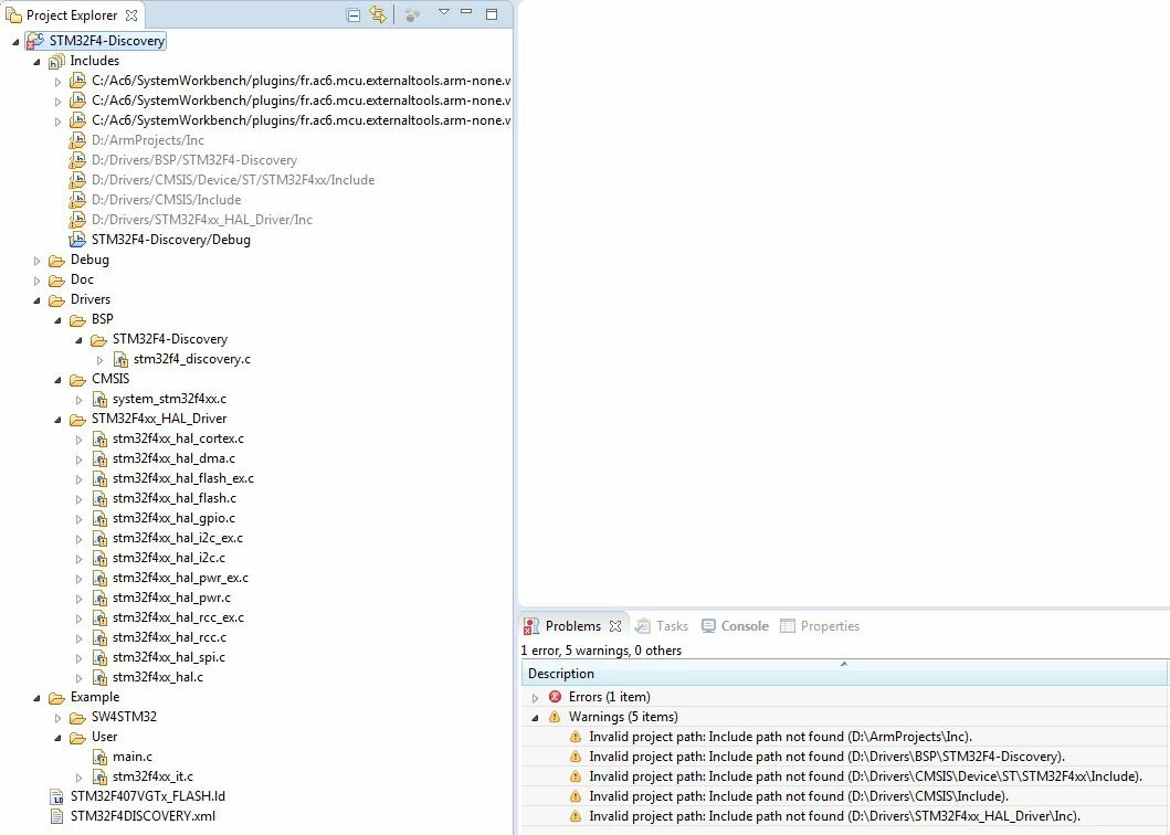

I tried some example ( e.g. example GPIO_EXTI ) from STM32Cube_FW_F4_V1.15.0 on my board STM32F407-Disc.
I used System Workbench for STM32 ver. 1.14.  It`s work well
if it is in the original directory.
But I tried to copy this example to my Workspace directory. In window 'Import Projects' I selected switch 'Copy projects into workspace'. (I follow the instructions of UM1730 page 17).  In 'Project Explorer' is appeared required project. But it didn`t work. There was missing the main.c file and many other files.
Is it a mistake in System Workbench or should it be done in a different way?

    I tried your instructions, but it does not work. I imported example GPIO_EXTI. In pictures is the result. In work directory still missing the necessary files (
    main.c file and many other files).

    I misunderstood your original question.   I thought you were trying to copy an existing
    working project in the workspace.  An Eclipse issue.
    The Eclipse project files are in:
    STM32Cube_FW_F4_V1.15.0\Projects\STM32F413H-Discovery\Examples\GPIO\GPIO_EXTI\SW4STM32\STM32F413H_DISCOVERY
    main.c is found in:
    STM32Cube_FW_F4_V1.15.0\Projects\STM32F413H-Discovery\Examples\GPIO\GPIO_EXTI\Src

        Even though I'm copying files main.c and mian.h, there are a lot of bugs there. I think the problem is in setting the right paths. But I do not know how to do it.
    Could anyone write me a precise point-by-point, what should I copy and where.
    I use board STM32F407-Disc1 and I need copy  GPIO_EXTI from STM32Cube_FW_F4_V1.15.0 to my work directory.
