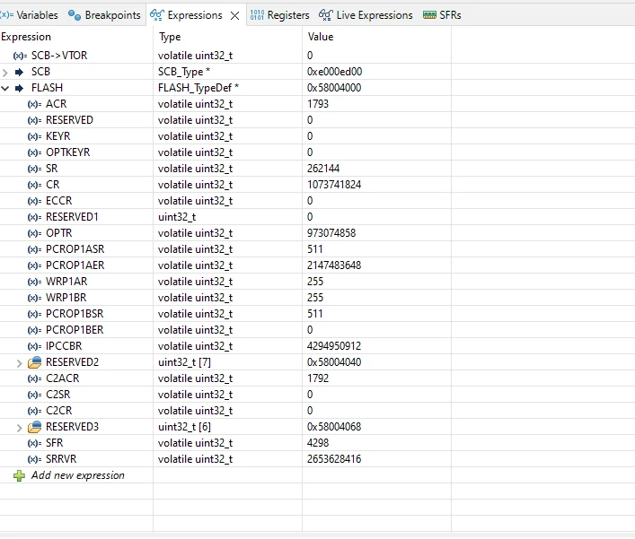

    This is where the Write is called after receving a command from Modbus Client.
    EE_WriteVariable8bits returns EE_WRITE_ERROR. Before executing EE_WriteVariable8bits I checked the FLASH.SR and the

    Screenshot the expression window

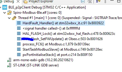

    _legacyfs_online_stmicro_images_0693W00000dDLWAQA4.pngIf I let debugger run , Hard Fault Handler is called. LAst know location is HAL_FLASH_Lock();

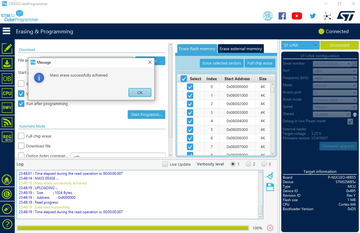

    Full chip erase works using Cube Programmer
    I was wondering if anyone knows resoution for this issue.
