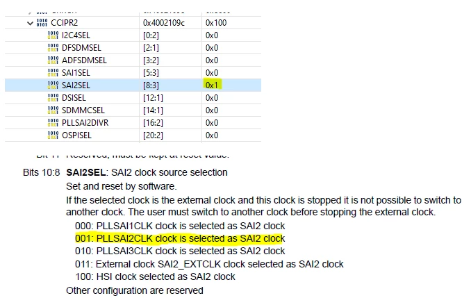

I found what's not correct!
There's a bug on SAI clock source selection. The impacted function is this:
LL_RCC_SetSAIClockSource(LL_RCC_SAI2_CLKSOURCE_PLLSAI1);
 ... even if argument is PLLSAI1 as source, it selects another value.
Looking at RCC register it has a value that does not correspond to the value specified on reference manual for PLLSAI1! It selects in that case PLLSAI2
Is there a way to report this bug ?
waclawek.jan
January 20, 2021
Nice catch!
And maybe this is a good indicator of what's the value of unnecessary intermediary "libraries"...
