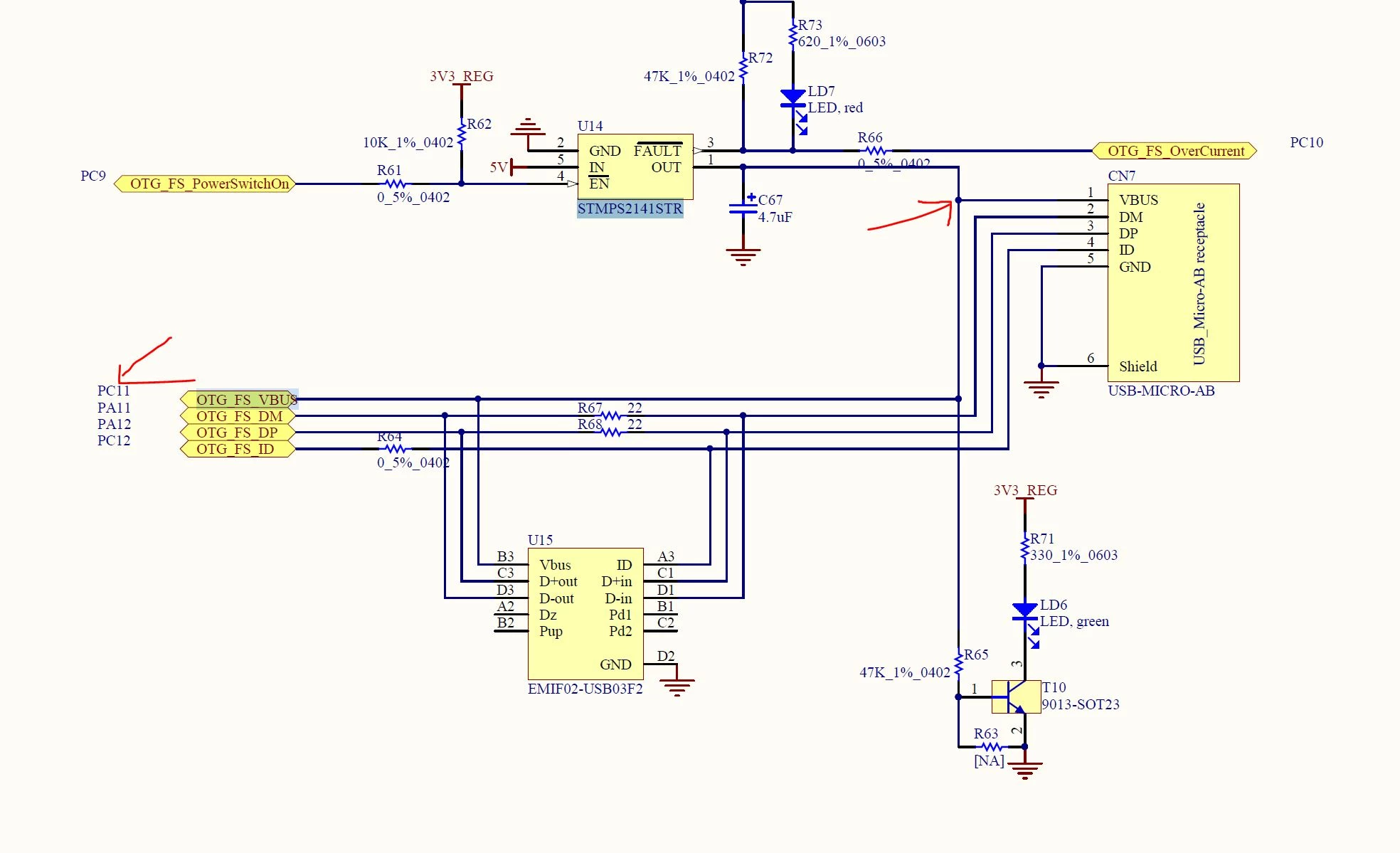

STM32L476G Discovery Board VBUS Voltage on PC11
  • May 15, 2020
  • 1 reply
  • 928 views
I have an question concerning the VBUS Pin which is connected to the STM32L476G Discovery (PIN PC11) directly. Why isn't 5V an problem for the PC11 pin? I thougt 5V would cause overvoltage?
1 reply
waclawek.jan
May 15, 2020
It's a 5Volt tolerant pin, of Ft type, see STM32L476xx pin definitions table in the 'L476 datasheet.
Note, that it's connected also to PA9 through SB24 - PA9 is the "native" OTG VBUS input.
