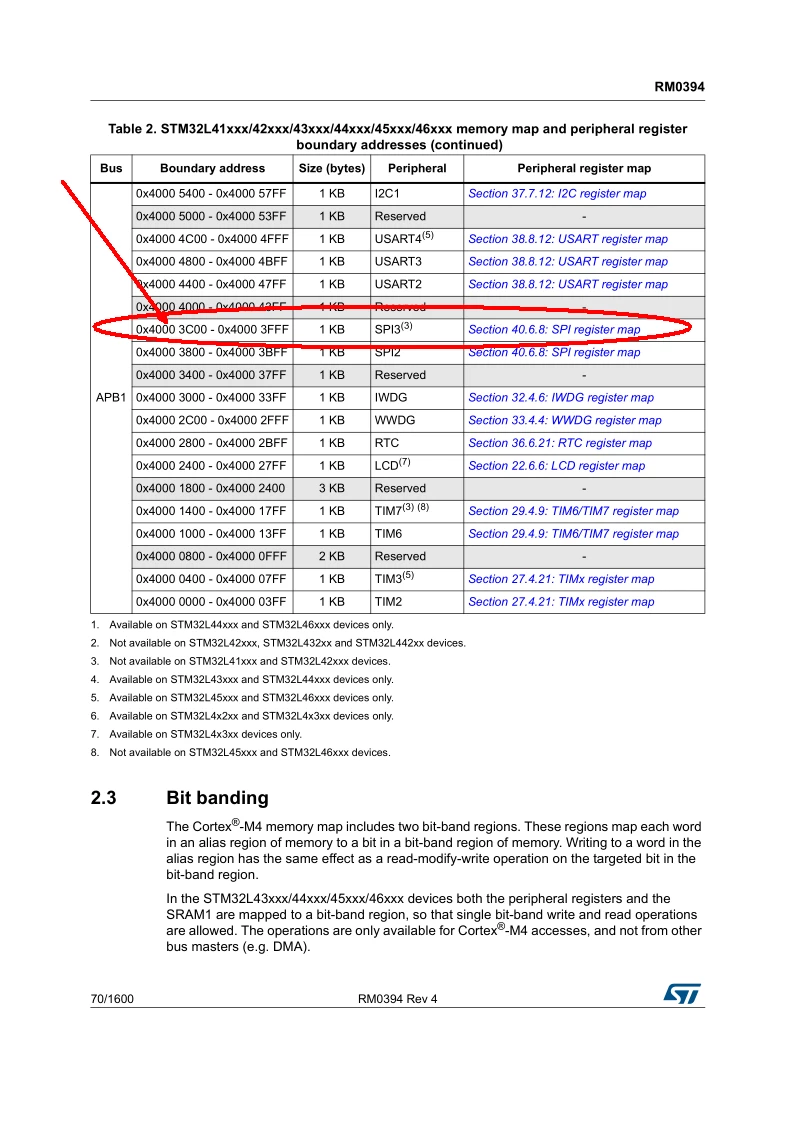

STM32L462 Can not start DMA transfer via SPI.
  • December 8, 2021
  • 5 replies
  • 1111 views
Enabled DMA2_CLK
SPI3_CLK
set DMA2_CSELR = 0x00000033;
GPIO is set up correctly and has clk enabled
CMAR1 CMAR2 CPAR1 CPAR2 s
Setup interrupts for DMAe Channel 1 and 2 and their priorities
setup spi3 cr1 cr2
DMA2_CNDTR2 DMA2_CNDTR1
RESET Ints with DMA2_IFCR
Followed the examples in order through HAL MXCUBE sample program
final steps
enable RXDMAEN
enable SPI3
enable TXDMAEN
sample program starts at this point, but my code does not
note from reference SPI3_CR2 bit TXDMAEN
Bit 1 TXDMAEN: Tx buffer DMA enable
When this bit is set, a DMA request is generated whenever the TXE flag is set.
Not starting.

Read out and post SPI and DMA registers content.

waclawek.jan
December 9, 2021
And the DR is at offset 0x0C, i.e. SPI->DR is at 0x40003C0C.
MDrak.1
MDrak.1Author
December 10, 2021
Yes I copied the register value incorrectly. Twice. In my code I had 0x40013c3c then I copied it to my list as 0x40013c03 and the correct value is 0x40003c0c.
I will test with that. Incorrect data register address should stop things from working. Thanks.

I ran the tests with corrected values and had more success. The DMA_Transmit started correctly. However the DMA Receiver was never started. The SPR Status register showed receive FIFO overrun. I could not find any SPI DMA Receive Interrupts that were activated when the transmit was in process or completed. Reviewing the details again.
