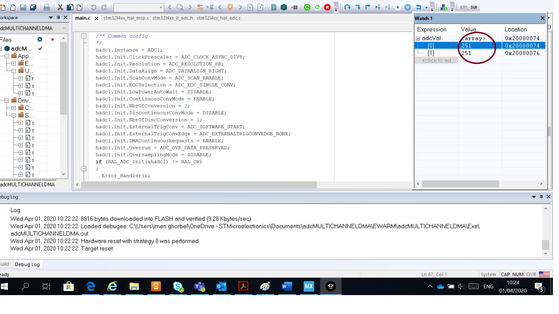

STM32L432KC I want to read ADC values using DMA. The problem is that I don't get any value in my array. I would like to do with HAL_ADC_PollForConversion, but doesn't work correctly it seems to read only one channel.

How are you triggering the ADC conversions?
RIzqu.1
RIzqu.1Author
April 1, 2020
I am triggering the ADC conversions with the option "Regular Conversion Launched by Software". Is it correct?
Thanks for your help.

I just took a quick look into your main.c ...
1st thing i´ve seen is the call to "HAL_ADC_Init(&hadc1);" just below HAL_Init();. I think, this can be deleted, because this call is already part of the function MX_ADC1_Init();, which is called a little bit later ...
Further differences i´ve seen are :
hadc1.Init.ClockPrescaler
hadc1.Init.ScanConvMode
hadc1.Init.NbrOfConversion
hadc1.Init.ExternalTrigConv
(surely not complete ... =) )
I´m not too familiar with ADC, i used it just once (like the guy from the video did...) for reading the percentage of a connected potentiometer
Imen GH
April 2, 2020
​Hello @Rubén Izquierdo​ ,
I made a brief comparison between my main.c file and your file. it's true that, we have the same configuration (but the order is not the same). In your main.C file, I confirm that you must remove the HAL_ADC_Init (& hadc1) just after the HAL_Init () ('already HAL_ADC_Init (& hadc1)' you will find it later in the configuration section of the ADC)
I already did the test on my side (as shown in the figure) no problem was detected.
Best regards,
