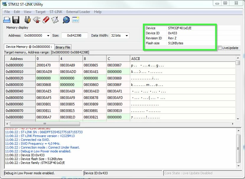

    Parmin Nayani
    May 25, 2017
    Posted on May 25, 2017 at 11:26
    Hi Max and Clive One,
    Here is the ID
    0690X00000603r2QAA.jpg got from ST_Link.

    Technical Moderator
    May 25, 2017
    Posted on May 25, 2017 at 17:22
    Hi
    Nayani.Parmin
    Could you pleasecheck with STLINK-Utility @address 0x00000000 if boot is configured to system memory where bootloader resides or not ?
    Thanks
