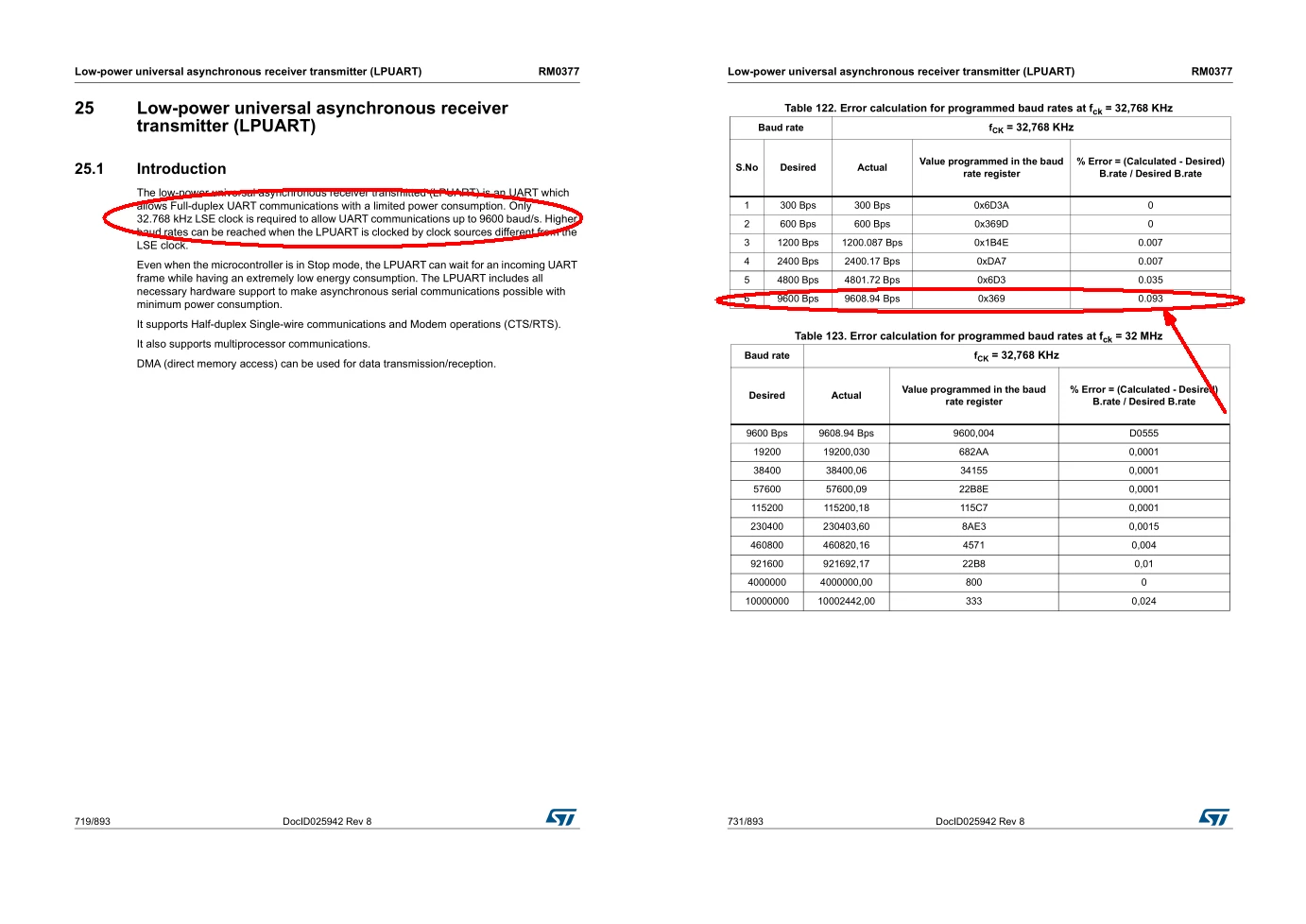

STM32L071 MCU LPUART use LSE to configure BaudRate 9600. Actual BaudRate is 8300 or 11000.Error islarge. LSE is 32.768kHz ,One cycle is 30.517 us。One cycle of BaudRate 9600 is 3.4 times of LSE。But LSE frequency division can only be an integral multip

So,is my idea right? The LPUART can not use LSE to configure BaudRate 9600?The error values in RM0377 are Wrong?Can you provide the actual error value when  configure BaudRate 9600?

Oops - @Community member​ is right. The values in RM0377 are correct because the 32 kHz is multiplied by 256 and then divided by the value in BRR.
The question now is what value @Wjian.4​ uses for BRR when trying to reach 9600 bps and where did he get it from?

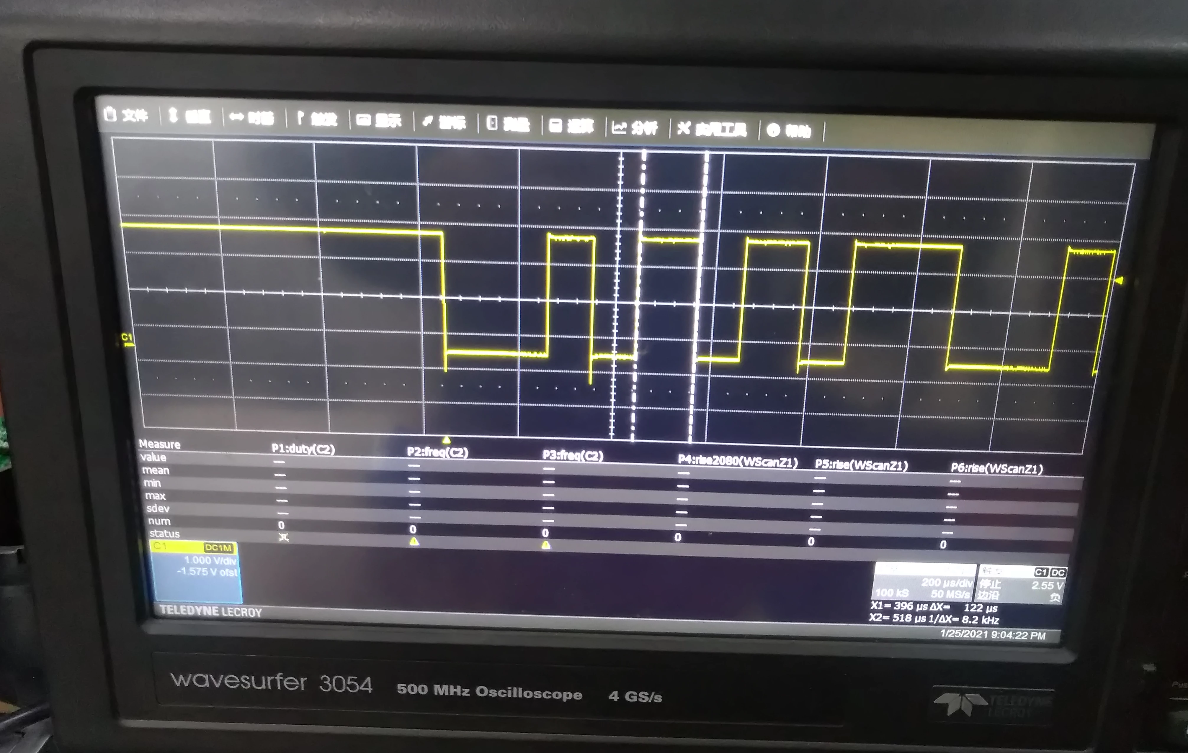

I don't think there's any multiplier (i.e. PLL) involved. IMO it *is* a lie, and attempting to Tx at 9600 will result in transmitting bits with duration alternating between 3 and 4 1/32768 periods so, that in the long term the bits duration averages to the required 3.4 periods. The Rx would sample similarly.
This has chance to work with a precise counterpart and no other sources of timing error (asymmetric skew e.g. using optocouplers or slew rate limiting transceivers with asymmetric receiver threshold, and similar); however, I see lots of chances to result in marginal or simply not working combinations, e.g. if you'd try to communicate using this scheme on both ends.

I tried.The value of BBR is set to 0x0036a.When the baud rate is set to 4800,The value of BBR is set to 0x006d4. And  actual BaudRate is 4672,The error is less than 3%. 32768 divided by 7 is 4681.So,the error of 4800 is small.As shown in the figure below,this is the actual baud rate when set to 9600.The pulse width of each bit is 8.3kHz or 11kHz.
Although the value of BBR is set to 0x0036a,but the fractional part of BBR(6a) no longer works.The total reason is that 32.768kHz can't divide the frequency to the corresponding period.
