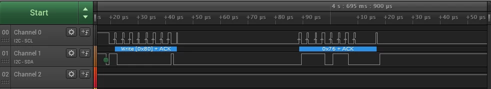

i use STM32CubeIDE with FW 1.60 with and want to use the I2C driver with DMA to read and write some data do a device.
I configured it properly in CubeMX and the code has been generated and all interrupts etc. are implemented.
When i test it with a logic analyzer (see attached file) only the WRITE command is send when i use HAL_I2C_Mem_Write_DMA.
while (HAL_I2C_GetState(&i2c_handler) != HAL_I2C_STATE_READY) {
	//i2c_get_device_response(hi2c4, I2C_JOYSTICK_ADDR_W);
 //	status = HAL_I2C_Mem_Write(&i2c_handler, i2c_dev_address, i2c_dev_register,
 //			I2C_MEMADD_SIZE_8BIT, (uint8_t*) pBuffer, 1, I2C_DEFAULT_TIMEOUT);
	status = HAL_I2C_Mem_Write_DMA(&i2c_handler, i2c_dev_address, i2c_dev_register, I2C_MEMADD_SIZE_8BIT, (uint8_t*) pBuffer, length);
	/* Check the communication status */
	if (status != HAL_OK) {
		printf("** Writing error i2c device: 0x%x.** \n", i2c_dev_address);
		I2C4_Reset();
It returns HAL_OK but basically, does not send the payload.
Is their any sequence that has tp be followed? Tell me if you need further details to give any recommendation.
