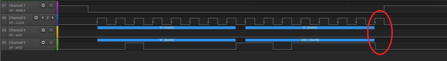

Hi there,
I am using the STM32H750VB as an SPI Slave in Interrupt mode and it is working but I am not happy with what I see with my analyzer.
SPI is working with Idle-Clock Low and aquiring data at leading edge. LSB first.
That's all how it should be but when you take a closer look at the last bit you see, that MISO is returning to zero just after the rising edge. In my opinion this should happen when the last clock is completed, e.g. falling edge of the clock.
Is there any way to delay this, as my SPI Master decodes the last byte sometimes as 123(0x7B) instead of 251(0xFB) as it reads the level of the MISO "too late".
The spi is working with a clock frequency of 50khz.
Thanks

waclawek.jan
May 8, 2020
Do you use DMA to fill the SPI Tx? If you change the next byte's LSB to 1, will you still see the problem?
Can you please read out and post the SPI registers' content?

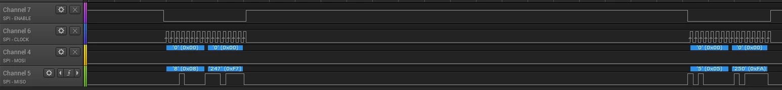

TAlbr
TAlbrAuthor
May 8, 2020
No I don't use DMA to fill the output buffer.
I use
HAL_SPI_TransmitReceive_IT(&hspi2,(uint8_t *)aTxBuffer , (uint8_t *)aRxBuffer, BUFFERSIZE);
to fill the output register.
The master always clocks out two bytes at once. If the next LSB is 1 I still see the problem. (Screenshot attached)
When do you want me to read out the SPI registers' content? Init, when Interrupt ist called or after "HAL_SPI_TransmitReceive_IT"
Thank you very much

waclawek.jan
May 8, 2020
> [when output buffer is filled]
Can you please toggle a pin *before* and *after* calling HAL_SPI_TransmitReceive_IT() and add it to the LA?
Any of these (say when interrupt is called), just tell us when whas it.
I just wanted to know how did you set up the SPI. I don't understand the Cube/HAL gibberish.
