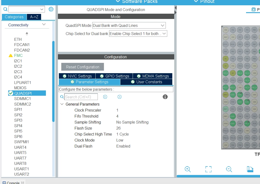

Hello All,
I am facing an issue with the Driver for MT25QL512 Flash Memory within the STM32H750DK. I followed the MOOC provided by ST and did the same things but it still times out in the CSP_QSPI_Erase_Chip() during the QSPI_AutoPollingMemReady() call. Sometimes it works but nothing is written in the Memory.
Thanks for your help in advance.
Ayoub

I have checked everything, timeouts, registers, preconditions but still doesn't work! what is strange is that I took the same code written by ST developers and shared in one of their MOOCs for the same memory I am using and it doesn't work!
I will keep investigating and update in case it is resolved.

Hello @Andrzej Węglowski​,
Sorry for my late response!
I found the solution. You need to configure the QSPI as dual bank as mentioned in the picture. 0693W00000HrVULQA3.pngIf you check the RM for the STM32H750DK you will find that it has 2 NOR Flashs of MT25QL512 so you need to configure it like that and it worked fine.
Ayoub
