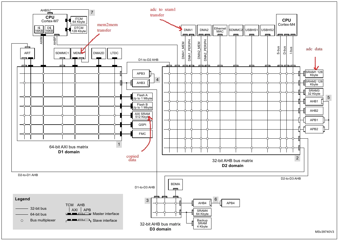

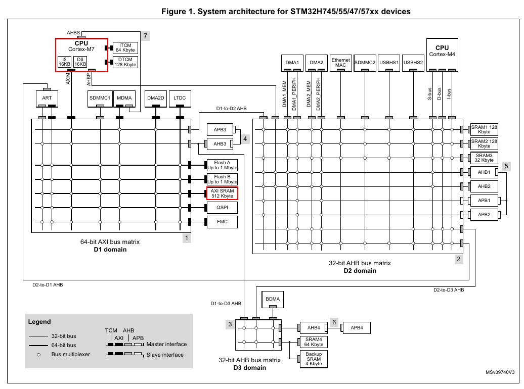

Also, given this system architecture0693W00000QMlXUQA1.pngI was thinking to start by putting everything in AXI SRAM 512kB block, do you see any problems in this?

Here's my plan for the memory usage, do you see pitfalls?
My concern is the d1-to-d2 bridge, but I don't think it could be avoided.0693W00000QN0jQQAT.jpg
