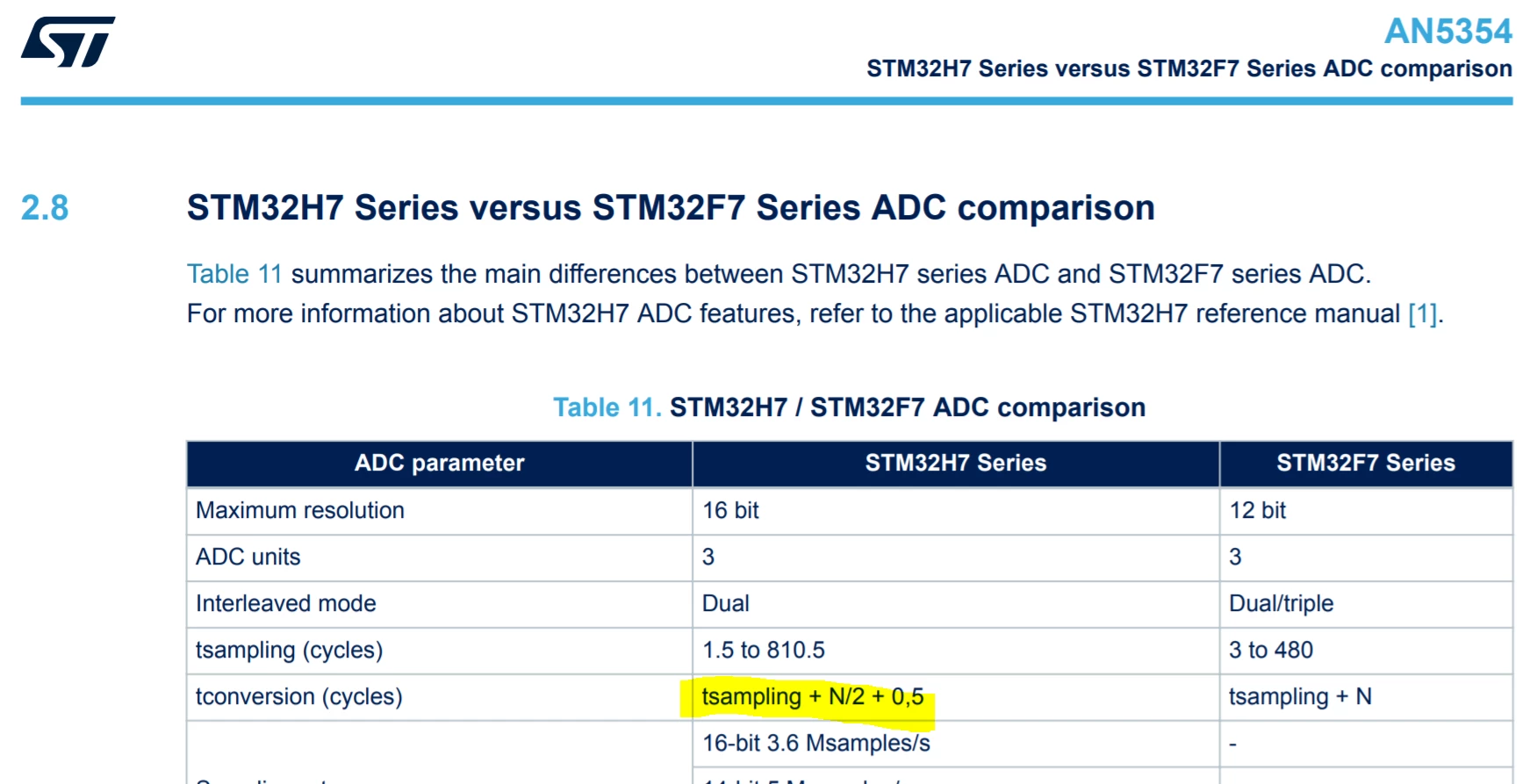

I have implemented 3 ADC with DMA. ADC1 with DMA1 stream 0 , ADC2 with DMA2 stream 0 and ADC3 with BDMA channel 0
Resolution : 16 bit , ADC clock : 7MHZ , Sample : 8.5 cycles
All these ADC are Time trigger for that i am using timer 1 as center aligned mode this timer will happen at every 20micro sec
how can i calculate the ADC total conversion time? and what i need to do for all the total conversion should happen within 20 micro sec?

> STM32H743
ADCs are independent. Conversion time is listed in the reference manual (I think) as well as here:
https://www.st.com/resource/en/application_note/dm00628458-getting-started-with-the-stm32h7-series-mcu-16bit-adc-stmicroelectronics.pdf
For 8.5sec sampling at 16 bits, conversion takes 8.5 + 16/2 + 0.5 = 17 cycles.
At 7MHz, that's 2.42 us.

@TDK​ Thanks a bunch! Theoretical Calculation i can understand for practical scenario how to check the conversion time
i tried with callbacks count as per my observation my expectation callback count was 50000 but i am getting around 25000
if you please guide me how to test the conversion time in code that could be very helpful for me

August 30, 2021
There's no way of exactly measuring conversion time in code, since code has overhead.
If you want to measure the number of conversions over a period of time, you can do so with DMA and the NDTR register.
Implementing a callback (possibly 3) which are executed every 20us isn't a great solution, but probably can work if your system clock is maxed out.
