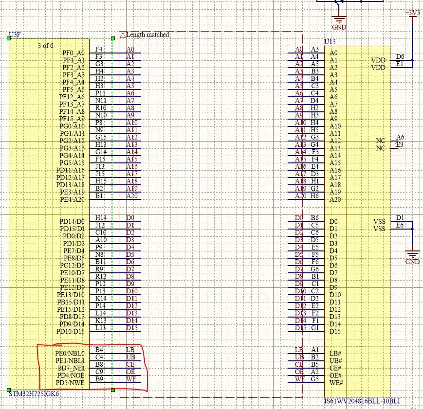

STM32H725IGK6 SRAM connection control signals review
  • May 8, 2023
  • 0 replies
  • 535 views
Hi ST team
We are using STM32H725IGK6 in our design with SRAM
Can you please review and let us know if the PINs used for SRAM are proper?
Mainly control signals
