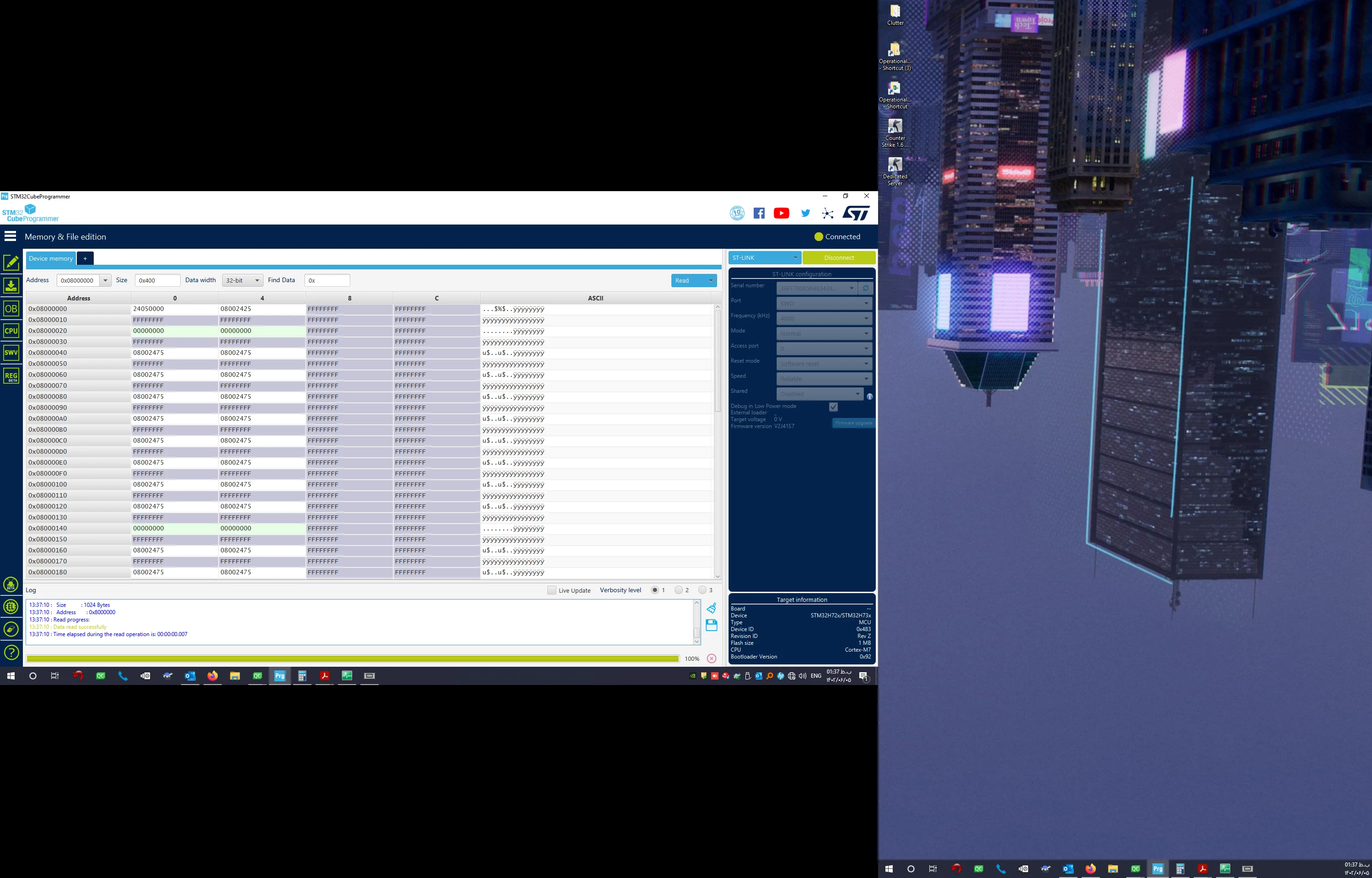

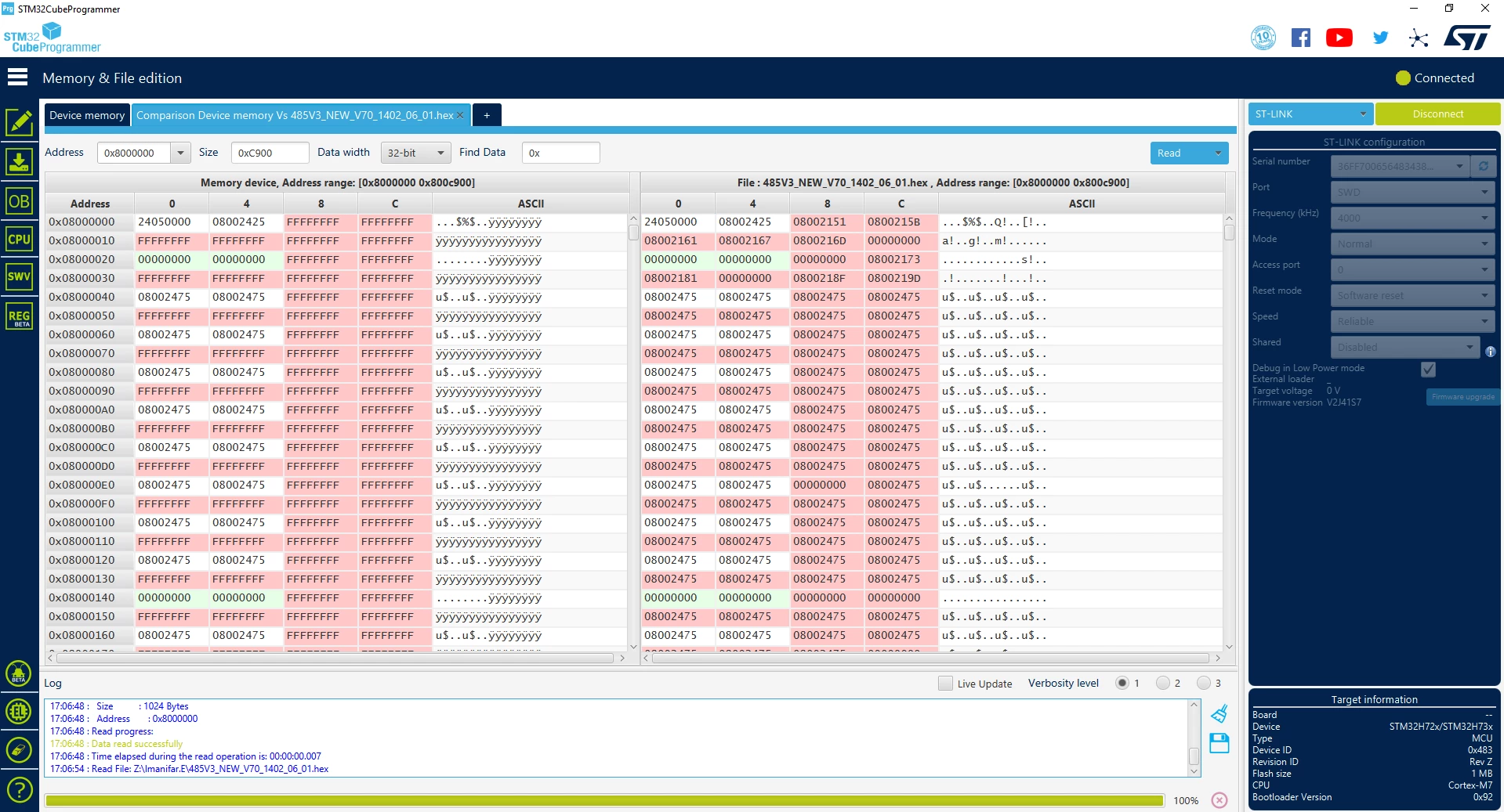

I Have worked with STM32h723 arm processor FDCAN bootloader. but I faced a strange problem in writing data into flash. I can successfully make processor go to FDCAN bootloader and get responses from it but can't write data in some address.(see images)
for example, I can write data in address 0x08000000 and 0x08000004 but I can't write data in 0x08000008 or 0x0800000C. it will filled with 0 or remains 0xFFFFFFFF.
I read AN2606 and AN5405 ST's documentation but has no results. also, I tested the bootloader in many ways and always it responds with ACK message, but data hasn't written in some addresses. Also I have worked on CAN bootloader on STM32F4 and that was so straightforward and worked perfectly but FDCAN bootloader in STM32H723 has painful behavior.

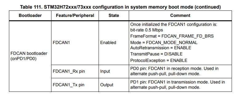

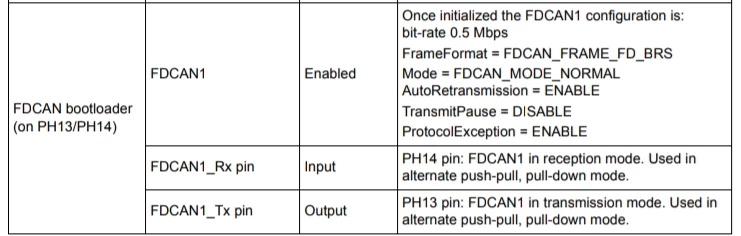

Have you verified that your configurations are compatible with configuration in system memory boot mode :
Best regards.
II
Technical Moderator
September 8, 2023
Hello @majid1 @Issamos,
Thank you for bringing attention to this I've just checked PH13 /PH14 are not detailed in the datasheet. So, you need to configure PD0/PD1 instead. An internal ticket 161018 is submitted to update AN2606.

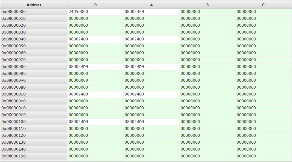

I configured PD0/PD1 Before as said in AN2606 and I can get responses from FDCAN bootloader. but I can't write data to some address. for example, I successfully wrote data in 0x08000000 but I can't write in 0x08000008(I attached images in my last post in this conversation) with write command. Also I checked that RDP and write data protection be off. every time I can wrtie in 0x08000000 but with same write command with different address like 0x08000008 data remains 0xFFFFFFFF or become zero.

I have a working Application to programm my STM32H730 MCU, but I'm always loading blocks of 256 Byte (maximum possibile), I have never tried to write single words, but reading the Reference Manual (RM0468 rev3, 4.2 FLASH main features ) I see that there is a limit of the minimal number of bit's to write to the flash (256 Bits in case of my H730), I think this is because of the ECC correction used on the flash. So probably you have to limit the flash write command address to 32 Byte bounderies, and write at least 32 Bytes per command.
