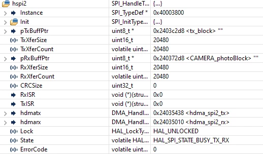

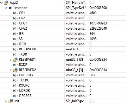

I am trying to use SPI and DMA in a STM32H7, but it is not worling. The spi handler goes to "HAL_SPI_STATE_BUSY_TX_RX" state as soon as i call the function "HAL_SPI_TransmitReceive_DMA" and it does not do anything, it does not even generate the clock signal. The CPU IChache and DCache are disabled and MPU is not used. Besides, i have placed all the memory sections in "RAM_D1" as you can see in the linker attached.
I have tried placing the DMA buffers in another memory section and place this in "RAM_D2". Besides, i have also tried aligning these buffers with "ALIGN_32BYTES", and using different DMA streams but the result is always the same.
0693W00000Ho84EQAR.png0693W00000Ho84YQAR.pngI would really appreciate any help, i am really stuck into this.

Probably a bug in your code, so show it. Verify DMA is initialized prior to SPI.
Alternatively, there are SPI examples in the repository you can go off of.
No need to store _user_heap_stack or bss in FLASH, although I don't think that's the issue.

I still don't think the error is within the code you've presented.
Is DMA initialized before SPI?

Sorry for the late. In the end i had to change it in order not to use DMA and i could not test it more time. I did not find the issue. Thanks for the help
