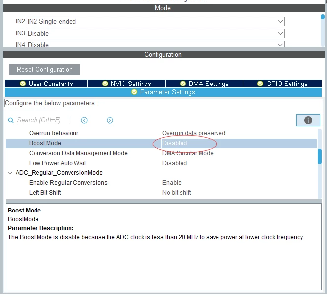

    With timer trigger, the sampling rate cannot reach 1msps

    Ok, so don't use the TIM, and let the ADC saturate in continuous mode.
    Pretty sure with the correct Prescaler/Period the TIM could clock generate an update at 1 MHz
    Single channel, 12-bit is supposed to hit 1.5Msps, triple interleave 4.5Msps

    how to use boost mode,I don't know how to setting in stm32cubemx
