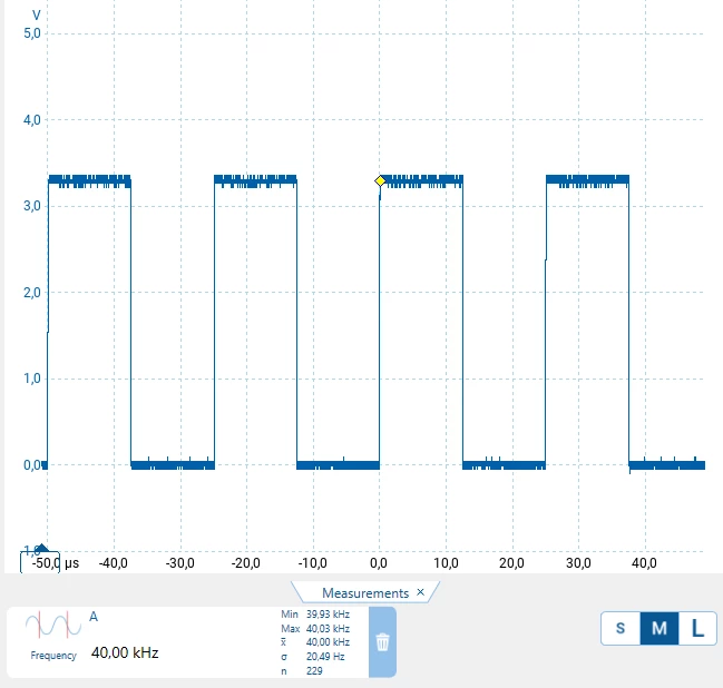

The point is that with this simple piece of code, everything runs as expected:
The frequency of the signal is 40.00kHz (the interrupt toggles the pin at 80kHz), so everythings OK.

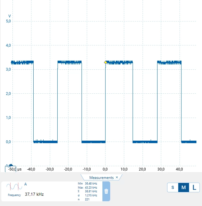

THE PROBLEM starts when I uncomment the code within HAL_TIM_PeriodElapsedCallback function. Only by uncommenting 4 lines of code (which are a simple macro generating a ramp from 0 to 1, a multiplication, a sine calculation and a Tim1 duty update), the frequency of the interrupt is not stable anymore.

The results are presented on the following image, where it can be checked how, for the (almost) same number of samples, the max and min of the frequency are way far from the 40.00kHz...0693W00000CzcRFQAZ.png

> Is there any evident thing I'm missing on the implementation of the ISR?
Nope.
> Is there any protocol in order to code within an ISR? Any flag to clear before coding or some way of calling the function
Nope.
> SOS
The chip can only do so much at once. Reduce the number of things you're doing in the ISR to help this (as you've already seen).
HAL adds overhead. If that causes issues for your project, you can ditch HAL and drive things yourself, but you lose parts of the HAL framework.
> RAMPGEN_MACRO (ramp_PWM);
> PWM_ABC_DUTY_A = 0.5+(0.5*(sin(PWM_ABC_RAMP)));
You say you're only adding 4 lines, but these two look pretty heavy. Using floating point in the ISR causes additional delays as it needs to push the FP registers onto the stack (and pop them afterwards).
waclawek.jan
July 14, 2021
I'd say, sin() is probably far more time consuming than the context push/pop.
Pavel A.
July 14, 2021
What is the priority of your interrupt? are other interrupts of same or higher priority enabled?
