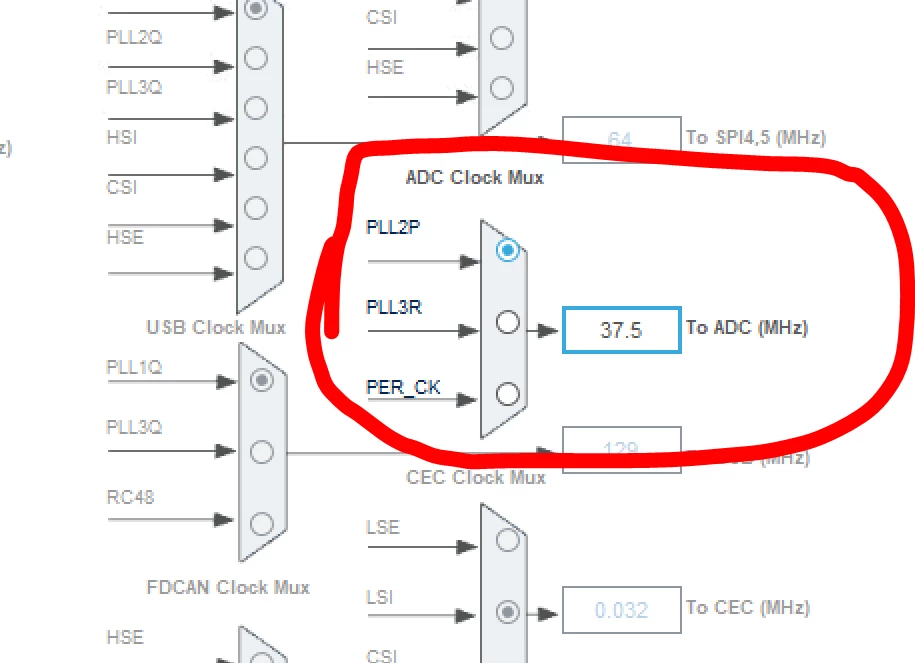

thanks for you answer. I will come back to you once I try this out on my board. I have another question regarding the initialization step for the ADC periphery. According to the reference manual you can select between synchronous and asynchronous Clokcking (kernel_clk). I see that the ADC provides 3 multiplex possibilites which is PLL2P, PLL3R and PER_CK , although PER_CK could be HSE or HSI or CSI. Which configration mode is seen as synchronous clocking when I need to call HAL_RCCEx_PeriphCLKConfig for the ADC periphery initialization or do I need to skip this and call another function ?

The code which is initialized by Cumbemx uses ADC_CLOCK_ASYNC_DVx defines which means the ADC is fed by a asynchrnous clock?
How can I change this to a synchronous PLL?

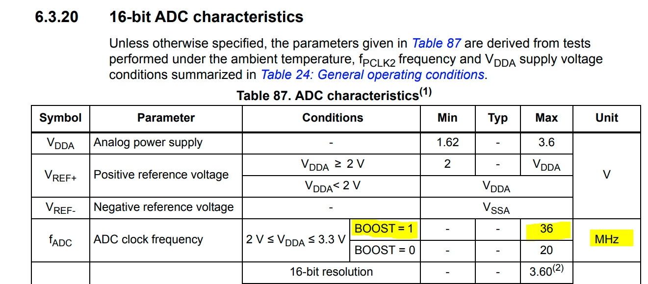

Moreover, which maximum frequency can be handled by the ADC periphery when used during operating as the multiplexed PLL can provide different frequency values?
July 4, 2021
Change it in CubeMX and let it generate the initialization code for you.
> Moreover, which maximum frequency can be handled by the ADC periphery...?
The max ADC clock is given in the datasheet. You don't specify what chip you're using. For the H743, it's 36 MHz. Probably better to focus on the needs of your project rather than maximum capabilities.
