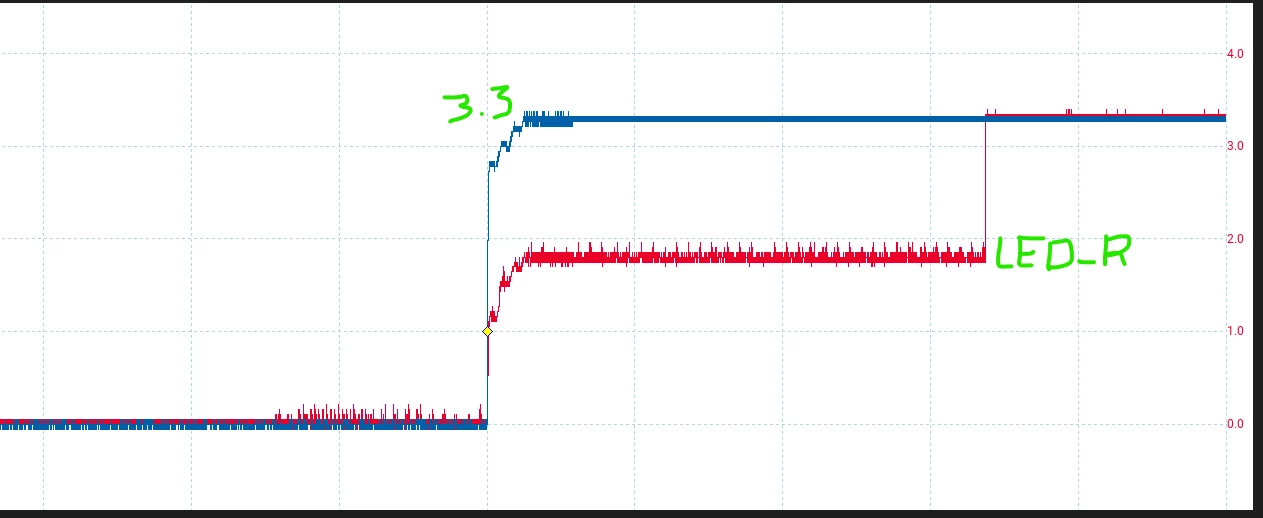

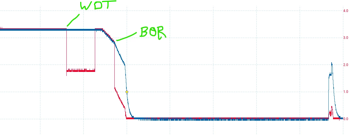

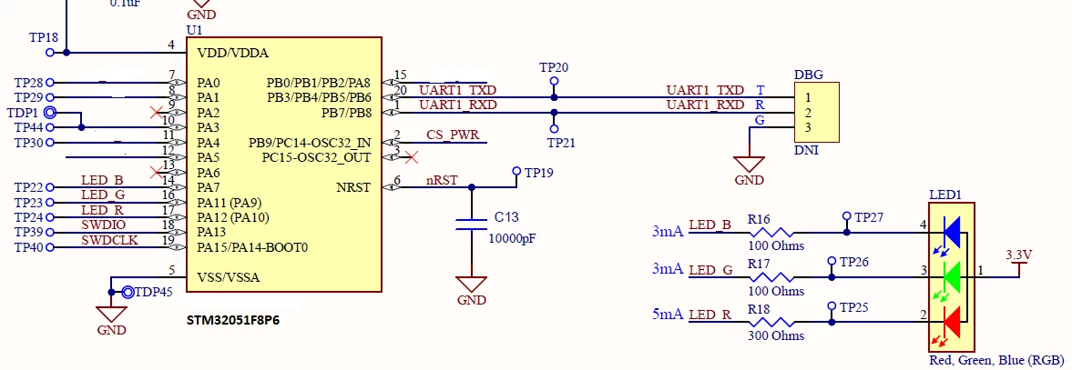

I have some strange behavior with a circuit.  My understanding is that the GPIO should be configured as an input at power up, however, I am seeing a brief flash on an LED during power up and Power down (images attached showing circuit and the 3.3 as well as LED_R signals).  In firmware, I am doing the following in the MX_GPIO_Init() routine:

So it is being SET before initializing the port.
Am I missing something as to why this LED is giving a brief pulse on power up or power down (as if the pin is allowing to sink a bit of current briefly until the rail goes away).
