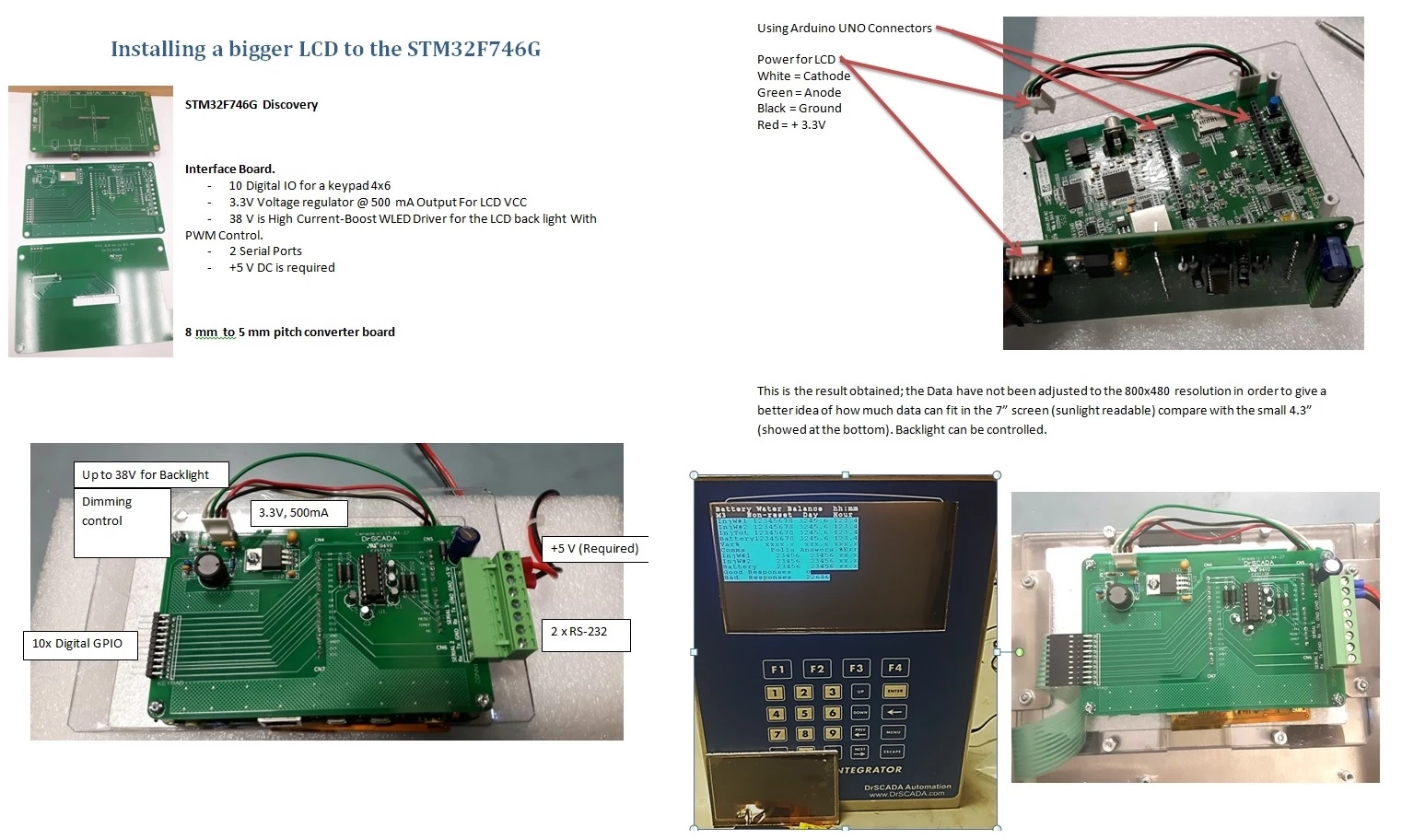

Alejandro Alvarez
Visitor II
May 30, 2017
Posted on May 30, 2017 at 23:21
This is How we solved the issue of having a small 4.3'' and also non sunlight readable LCD.0690X00000603rCQAQ.jpg
