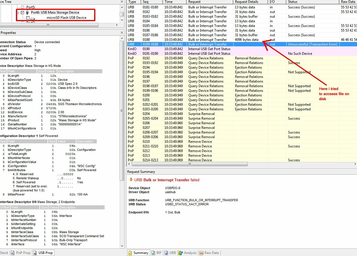

Hi to All,
Setup:
STM32F4DISCOVERY board connected to SMS USB3320 HS PHY.
CPU Clock : 168Mhz from HSI.
USB Class: MSC - mass storage device.
Problem:
The device descoravble by PC  I can see files on the Flash disk but when i trying to
make changes (save,open,delete .. ) the device removed and moved to unaccsseble state
(only reset helps).
I did change settings to work it as FS device MSC and no problems at ALL.
Do someone met same problem ?
Where to start looking ?

    How about the capacity of the power supply (or voltage regulator)?
    FLASH erase/write, either on-chip or SD card, consumes more current than read.
    In high-speed, data comes more frequently than in full-speed.
    That is, the average current consumption is much greater in high-speed.write.
    Also, ULPI PHY eats power a lot.
    If your entire system would be supplied by the regulator (U1 LD3985M33R) on the Discovery board, it should get hot. For ULPI PHY (and external circuity), add another 3V3 regulator, supplied from 5V rail.

    Hi Tsuneo,
    You are correct !!!
    Place regulator for USB3320 and for uSD - it works Ok Now.
    You are helpful as usual - thanks.
