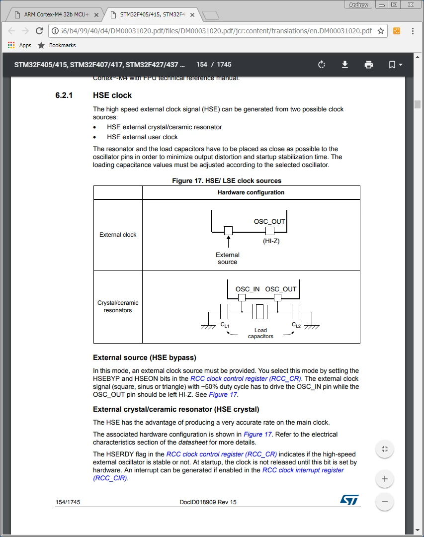

    Posted on March 21, 2018 at 08:13
    With external clock source you should set HSE to BYPASS.
    To which pin is the clock connected?
    You can check it with outputting HSE to MCO pin.

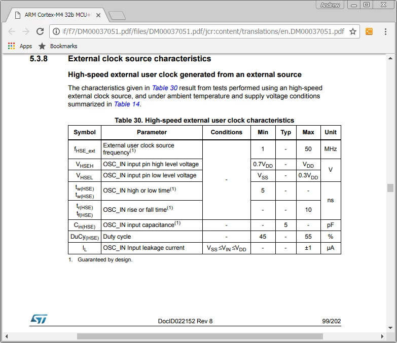

    Posted on March 21, 2018 at 08:49
    50 MHz seems a bit high  - officially (DS) only quartz frequencies from 4.0 MHz to 24.0 MHz are supported.

    Evelyn Sabbag
    March 21, 2018
    Posted on March 21, 2018 at 14:15
    Thank you, Andrew, for the reply. The datasheet, DM00037051.pdf, mentions the 50 MHz OSC in Figure 98, but doesn't really provide any more information. The reference manual, en.DM00031020.pdf, is what I was missing. However, other than the bypass, it doesn't provide the same level of detail as the Clock Configuration tool.
    Once the bypass is selected and HSE is on, how does the /2 get selected? From the block diagram, either /2 or /20 is possible. And, once this is setup, can the HSE be treated as 25MHz in order to set the other parameters? I.e. PLL_N, PLL_Q, PLL_M, etc?

    waclawek.jan
    March 21, 2018
    Posted on March 21, 2018 at 16:17
    Which block diagram are you talking about?
    No, treat it simply as 50MHz... As far as PLL is concerned, the simplest way is to take the parameters you had for 25MHz and multiply the predivider (PLL_M) by two.

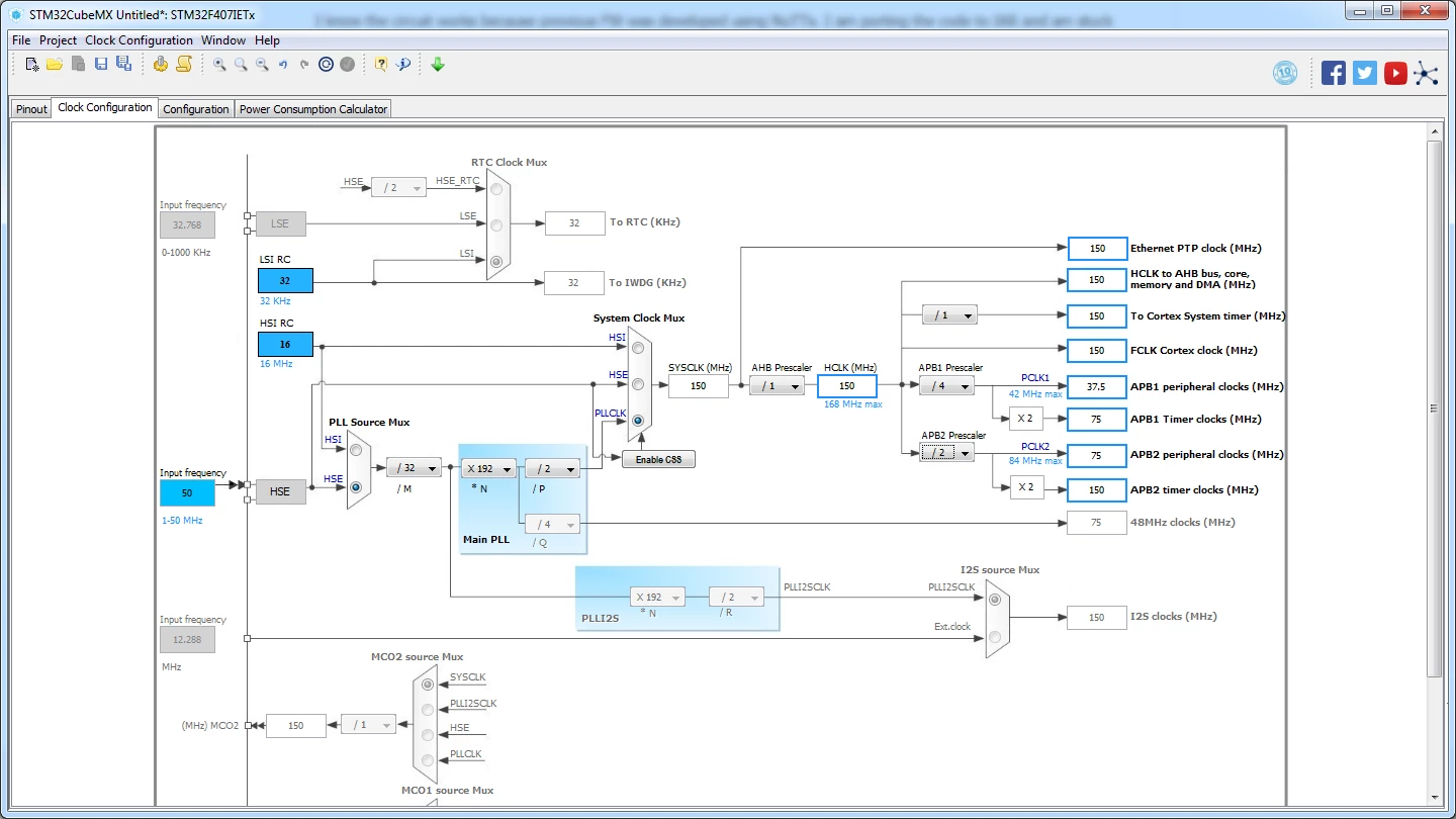

    Bill Dempsey
    March 21, 2018
    Posted on March 21, 2018 at 17:38
    For some reason I don't see anyone mentioning the obvious - STMCube clock manager.  You can set 50MHz and then tweak away at the internal dividers  This is an example.  It can produce the necessary clock setup code only if that's what you want.
