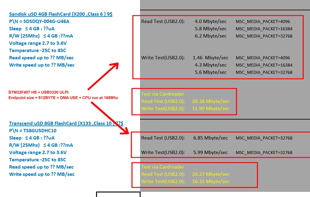

HI,
I did connect STM32F407DESCOVERY to SMSC USB3320 ULPI (USB High Speed mass storage configuration). And uSD curd via SDIO interface.
The MCU configured to work in its maximum performance:
CPU clk 168Mhz , Enpoint 512byte + aditional endpoint enabled + USB DMA enabled
+ SDIO DMA Enabled.
However the maximum read\write speed for uSD cards of class 6 \class 10 is about
6 Mbyte\sec. When i connect these cards via card reader i get speeds of 20Mbyte at readings.
My quastion:
Is it maximum available speed (6MB\sec) that can be achieved using STM32F4 in MSC configuration ?
Do anybody  get better results ?

    No doubt because you have a number of serialized operations:
    READ MULTIPLE SECTORS FROM SD CARD,
    WAIT TILL COMPLETE,
    SEND DATA OVER USB,
    WAIT TILL COMPLETE,
    REPEAT
    In system where you get 15-20 MBps you've cut out several of these steps, and perhaps a bus or two.
    Silicon implementation designed for MSC deliver the data directly from the mass storage device to the USB output stream with minimal latency/lag, and a hardware FIFO structure to provide some elasticity.
    Of the ST examples I've observed you have TWO independent DMA operations, and minimal, if any, overlap between them.

    Thanks,
    I see.
    So to get maximum performance i need use some bridge usb-sd like
    http://www.maxim-ic.com/datasheet/index.mvp/id/6226
    To your openion the speed i get 6Mbyte\sec is somthing that
    suites the STM32F4 limits or i can get more speed (up to 10 maby) ?
