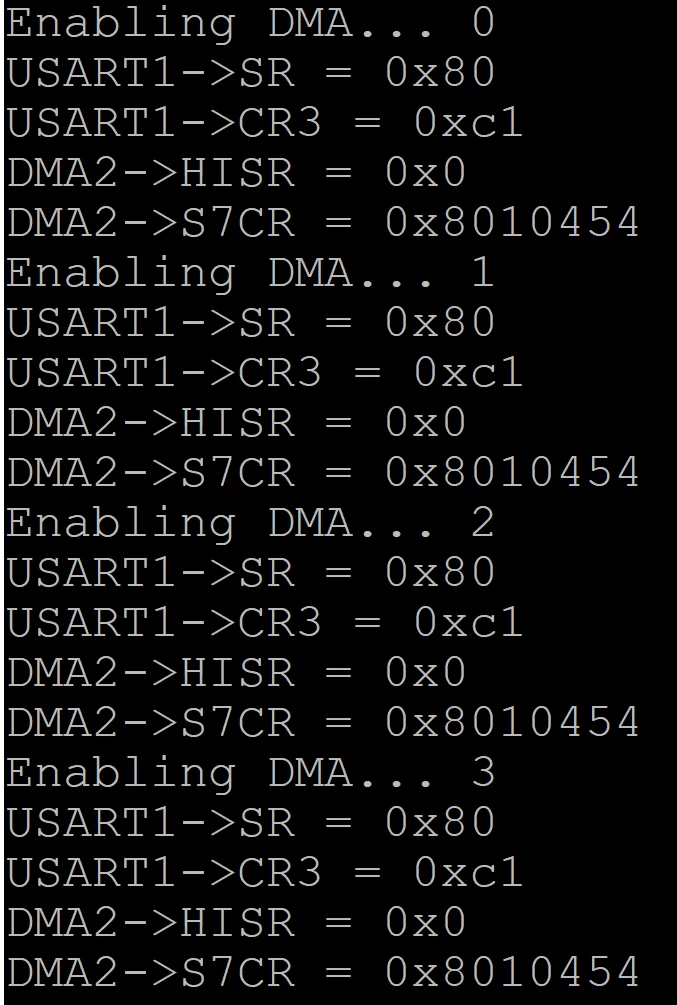

I'm using STM32F407 in my project and I use DMA2 on USART1 RX/TX. Since my TX packet length changes almost every time, I'd have to disable DMA, reconfigure it to the correct data length, and enable DMA. I'm doing this at least 100Hz if not more. And I don't know if it's because of that, the DMA would fail to enable after random periods of time. I write 1 to the EN bit in the control register and poll it to make sure it actually becomes 1, but it never does. I'm not sure what the problem is, since it always works for a few minutes then stops working. Another interesting point is that the DMA2 RX doesn't stop working at all. If anyone has any pointers I highly appreciate it. Thanks!
Here's my USART1 TX and DMA reconfigure code: (by the way, the printf statements printed out the same values when the DMA is working and when it's not)

Have you consulted the errata?
Does this run in some multitasking environment? If so, can't there be hazards from other threads? Do other thread access DMA2 registers (including clearing the DMA2 status register)?
I see printouts at the disable stage. When the problem occurs, do you receive some of those printouts?
So the Rx DMA remains working and data *are* arriving while you are waiting for the Tx channel to be enabled? Any other DMA2 channels enabled and active? I am asking because IMO there may be interactions between the DMA channels.
Can you read out the DMA status register and the relevant DMA channel registers' content, when the problem happens, and post here?

The DMA registers, when the problem happens, read like this:
Sorry that the information I have doesn't directly solve the problem. But if anyone else has the same problem this could be helpful to them.

So the status flags are cleared, and still the EN bit won't be set... humm.
Can you please tell us about how do you handle the reception? Do you reconfigure its DMA?
I see you have transfer-error interrupt enabled. How is it handled? Does it happen? Doesn't it happen just before the problem?
Can you please make a copy of the HTIF before you clear it, into a local variable, and then print it out when the problem happens?
You don't enable/disable or reset the UART, do you?
You don't observe the USART and/or DMA registers in a debugger while the application is running, do you? If you do, please disconnect the debugger and try to run the application without it.
