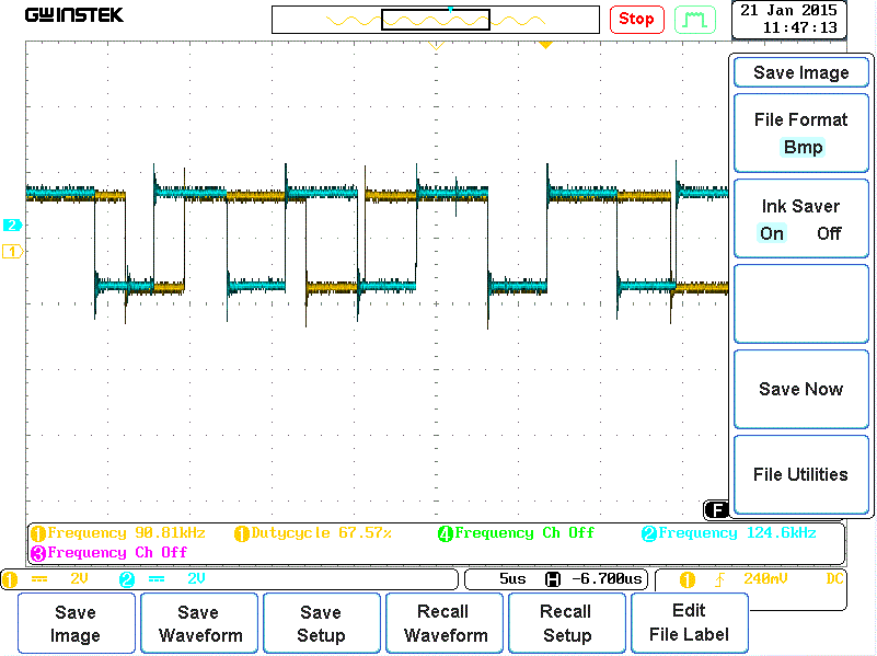

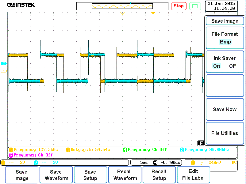

Have anyone ever had trouble when updating frequency can cause the two complementary pwm outputs not have the same frequency?
I'm using STM32F407VGT6 Discovery, controlling the PWM frequency.

    I have just taken some retests, disabling the complementary output. And I found out that the frequency difference also occurs between two active PWM output Channel 1 (PA8) and Channel 3 (PA10).
    It occurs both between two complementary outputs and between two outputs of two channels

    I'm using Kit STM32F407VG Discovery to control frequency of FullBridge LLC Converter. I use 50kHz Interrupt TIM2 and CH1,1N,3,3N PWM TIM1. The PWM frequency band is 80-140kHz.When updating new frequency (TIM1->ARR), the frequency of 4 PWM outputs is randomly not the same, shortcircuiting my converter.
    I have no idea to do next. Please help me!!
