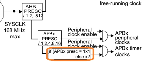

i used timer2 and it's clock source from  APB1   and Prescaler  value for  APB1 is 4
it's mean's APB1 work at 42mhz     ''168mhz/4 ''     becuase the maximum  frequency is 42mhz for APB1.
i searched in internet and some people write the timer2 clocked at 84mhz  not 42mhz and it's true.
but i cant find in this stm32f4 datasheet
    1 reply

    Posted on June 11, 2013 at 00:18
    Yes, review the clock tree in the Reference Manual. For DIV2 on the APB it is DIV1 on the TIMCLK, for DIV4 on APB it is DIV2 on the TIMCLK
