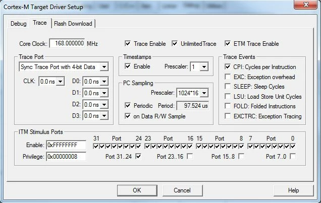

I'm using ULINKpro and Keil uVision 5.23.0.0 as debugger.
I can't make ETM Trace (sync mode, 4-bit data) works properly on a STM32F427ZG with a core clock of 168MHz.
I tried to lower the core clock working frequency to 42MHz, and that made Trace starts working. It's a problem of too high frequency?
Before this one, I tried to configure Trace on a STM32F407ZG, on the same board (pin-to-pin compatible) and with the same software (except for small mandatory fixes due to the different microcontroller). S
trangely
enough, this one works also at 168MHz, with the same Trace configuration!
Here is the configuration screen:
This is the initialization file:

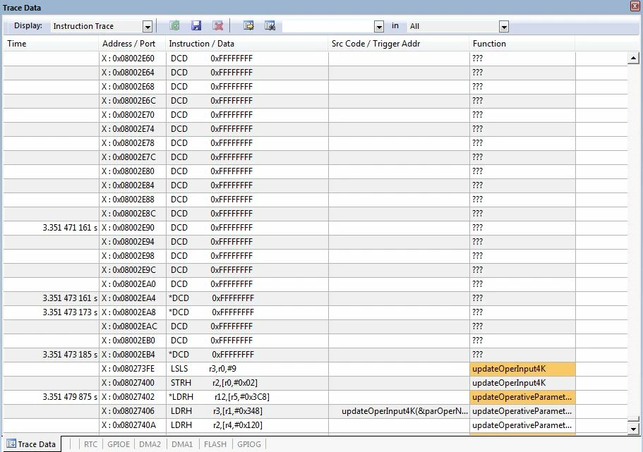

When I run the debug, Trace status is ''Data stream error''. When I stop the execution, there is an attempt to process the captured data, and after an
anomalous
long time I get something like this:0690X00000603m7QAA.jpg
Best regards.

    Hello
    Generally, ETM will work to only approximately 100 MHz...maybe a little higher..
    This depends on several things: the chip itself, drive characteristics of the 5 ETM output bits, the clock frequency and the board layout (especially TRC_CLK).
    Since only program change frames are sent out the ETM port, more branches in your program might cause this 4 bit port to become overloaded.
    You can try and run the CPU clock over 100 MHz to see how far your particular system can run at.
    Please see the attached document on pages 30 - 40 for ETM info. This is on the Cortex-M7 but is applicable for the STM32F4 processors.
    It describes how to lower the CPU frequency to 100 MHz.
    Note that recently the .ini file used for configuring ETM ports and or SWO might/can be provided in the Software Pack.
    If you know where the Trace tab is in uVision, in some newer Packs there is an extra tab called Pack. You can enable/disable the initialization and see the contents of this new .dbgconf file.
    The ini file that usually comes with uVision is slightly different than the one shown above. Look for an example from Keil Software Packs called Blinky_Ulp.
    Note: The Core Clock: frequency does not need to be correct to get valid ETM trace frames. However, uVision uses this value to calculate timing values displayed in some windows.
