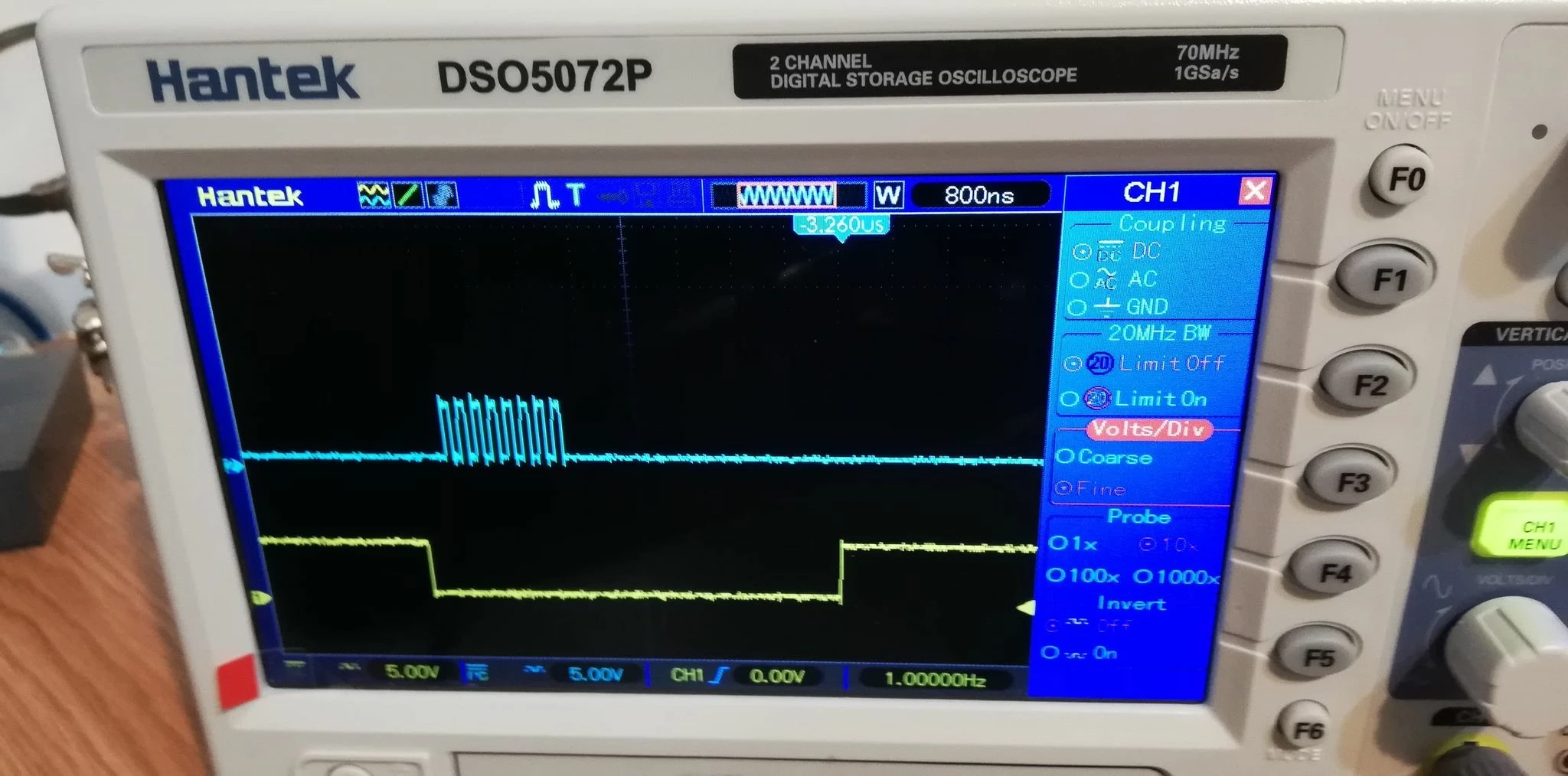

I got an oscilloscope and did some testing with it. Also created a new project from scratch for my board(STM32F407G disc 1) with CubeMX and configured SPI1 as follows:
- full duplex slave
- NSS: Hardware NSS Input signal(input hardware)
- Motorola, 8 bits, MSB first, CPOL-LOW, Clock phase-1 edge
- Enabled SPI1 global interrupt under NVIC tab

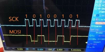

And now I'm sending value 165(1010 0101) from the arduino every 1 second.
I have checked the pins with an oscilloscope and the message coming from the arduino seems to be ok. The speed the arduino is sending messages is I think 4Mhz so speed should not be an issue I think since SPI1 of the discovery board is sitting on a bus with 42Mhz speed.
So basically I just generated the code with cubeMX, I wrote no user code whatsoever other than HAL_SPI_Receive_IT(&hspi1, &_spi_data, 1); before entering the while(1) loop and put a breakpoint in the global ISR handler function: SPI1_IRQHandler from generated file stm32f4xx_it.c.
Now since the arduino is sending data properly judging from what I've seen on the scope I guess there is a problem somewhere with the configuration code from the CubeMX something that perhaps I'm forgetting to do but I can't figure out what exactly.
Now in CubeMX I have some warnings such as:
'Partly disabled conflict with SPI1: Hardware NSS Input signal'. Could that be a problem? I mention that I get these warnings on some peripherals which I have disabled in my project.
Below are the oscilloscope snapshots:
This is MOSI(yellow) data comming from arduino(master).

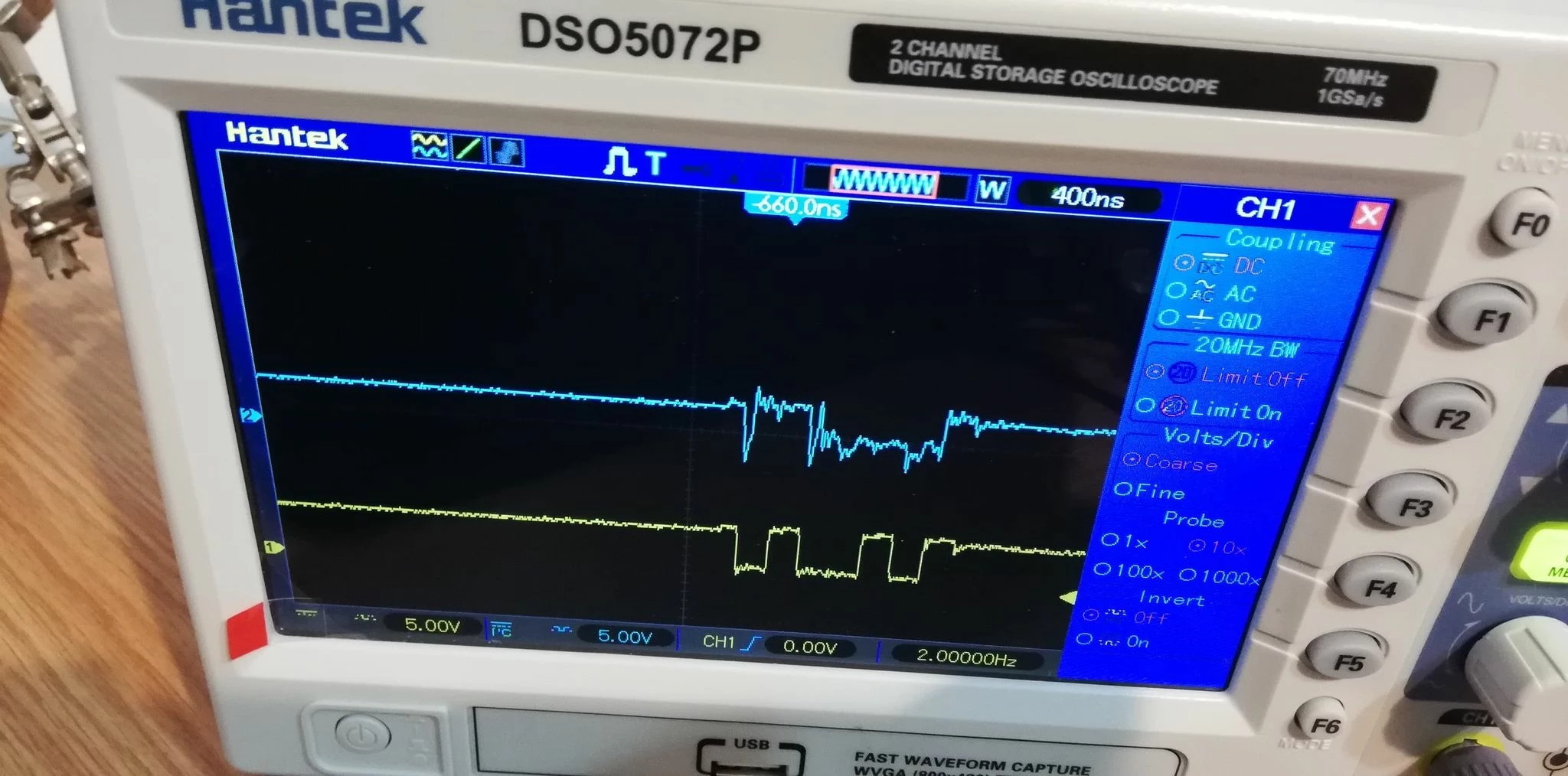

MISO(blue). I'm not sending anything from the code on my ST board I guess the value there is because of the way SPI works in hardware(circular buffer).
0693W000005Bvs3QAC.jpgThis is SCLOCK coming from the master(arduino) and SS.
