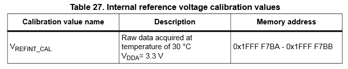

    fjanus
    Visitor II
    July 22, 2014
    Posted on July 22, 2014 at 16:07
    Hello Colleagues,
    where the heck ist the calibration value to be found?
    The data sheet states: ''
    To improve the accuracy of the temperature sensor measurement,
    each device is individually factory-calibrated by ST. The temperature sensor factory calibration data are stored by ST in the system memory area, accessible in read-only mode.''
    Can anyone point me to the right loaction?
    rgds
