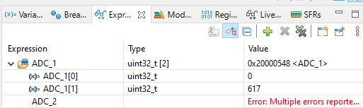

I'm almost new to the STM32 and have the following question:
I'm triggering multichannel ADC1 conversions using timer 1 and storing the readings in a buffer using the DMA. It works fine until I configure ADC2 (which doesn't support DMA) to be triggered by timer 2. The sole addition of HAL_ADC_Start(&hadc2); or HAL_ADC_Start_IT(&hadc2); at the beginning of the code causes corrupted readings from ADC1+DMA. What am I doing wrong? Is it possible to trigger other ADCs while using DMA with another channel?
Thanks in advance

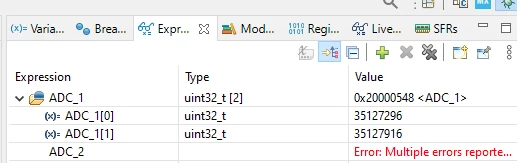

Thank you for the answer, The readings go from:
0693W00000JObqmQAD.pngto
 0693W00000JObrLQAT.pngonly by adding HAL_ADC_Start(&hadc2);
the sample is triggered in the second event of a capture compare running at 20Khz, so I suppose the sample rate is 10Khz

Changing DMA to Half Word and, consequently, the buffer data type to 16 bits did the trick. Still don't know why Thanks!
