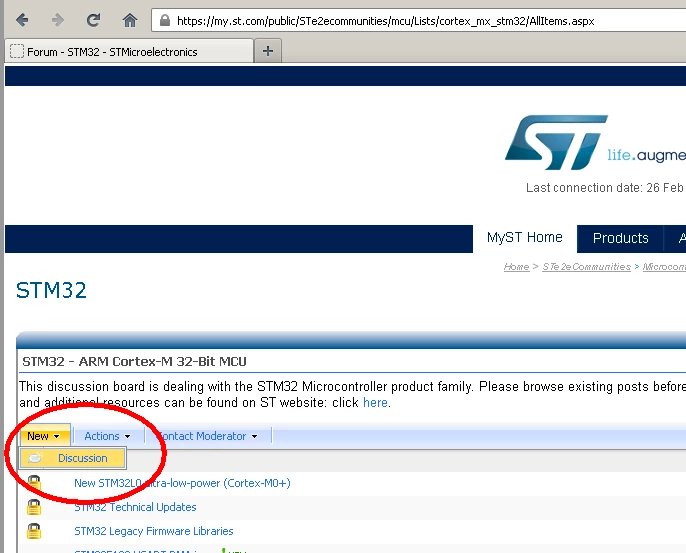

    anhhuy0701
    February 26, 2014
    Posted on February 26, 2014 at 16:12

    waclawek.jan
    February 26, 2014
    Posted on February 26, 2014 at 16:24
    > hello admin, how can I post a question on this forum?
