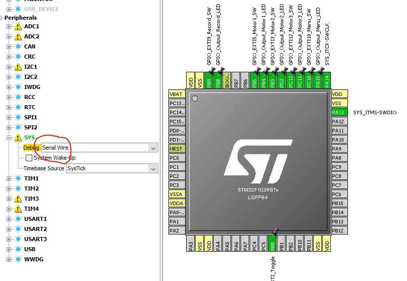

I am using  a custom board in which i have connected 5 switches to the pins as given below and pins are configured as Pull Up and i am triggering interrupt on falling edge
PB9 <===> External Switch 1
PB5 <===> External Switch 2
PB3 <===> External Switch 3
PC12 <===> External Switch 4
PC10 <===> External Switch 5
Also i have checked the  connection with the help of Digital Multi meter where  whenever i press the Switch the connectivity is established and when i release it connectivity is broken with ground , But still in call back function for ' PB3 <===> External Switch 3
 ' i am not getting any response but for other Switches I am getting updates they are interrupting my CPU and in call back also i am able to see the updates,
That is i checked with this by inserting the break point for every switch condition in call back function But the other switches  apart from ' PB3 <===> External Switch 3
 ' execution flow goes to the break point when switch is pressed, but for switch 3 execution flow
doesn't goes to Break point when the switch is pressed
Please tell me if  Am i missing out on something while Enabling the interrupt or in configuration Tab,in below paragraph i described the details in cubemx which i have followed,
In cubeMx firstly i used 5 pins which are connected to switches and configured them as GPIO_EXTIx  also enabled their respective interrupts in NVIC in configuration tab that are External Interrupt 3, External Interrupt 9:5 and External Interrupt 15:10, also for indication i have connected 5 pins to different LEDs and configured them as Pull up and triggered when falling edge

    Vangelis Fortounas
    September 22, 2017
    Posted on September 22, 2017 at 14:22
    Hello!

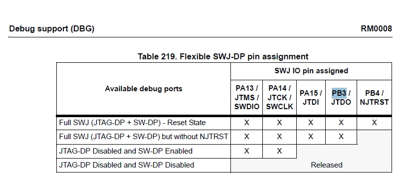

    In Pinout tab->sys select the serial wire mode to release the PB3 PB4  and PA15 pins from TRACESWO NJRST and JTDI  functionality(default)
    regards

    Utkarash Patil
    September 23, 2017
    Posted on September 23, 2017 at 05:47
    Thank You for reply It has helped me a lot and now my issue is also resolved,
    Thanks a lot for helping and providing such a good guidance.
    Vangelis Fortounas
    September 22, 2017
    Posted on September 22, 2017 at 17:26
    I found also that you haven't  updated your firmware library(you use 1.4vs 1.9), This problem caused when you selected at Pinout tab->sys 'Î�o Debug'. Normaly the CubMx must have produced   __HAL_AFIO_REMAP_SWJ_DISABLE(); at stm32f1xx_hal_msp.c file  but didn't produced.
