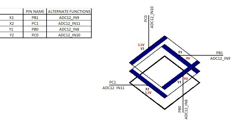

I want to communicate with my touch screen without controler.
I can display pictures, lines, colors, circles, texts...
I've a 4-wire resistive touch screen on my lcd (4,3'' TFT COLOR).
For the moment, I can see the voltage on the multimeter with this code.

Now I want to configure the ADC and try to use the touchscreen, but I've no idea how to do this?
If you can help me.
Thank you

    Posted on April 27, 2012 at 10:15
    Yes, i know that is better to use a controller.
    But the hardware is done.
    I have configured my ADC  :

    But my question is now that my ADC is configured. How can I make to read my ADCvalue (ADC12_IN11-ADC12_IN9 == X2-X1 == a value that I need to convert)?
    Thank you
    Thank you
    raptorhal2
    Lead
    April 27, 2012
    Posted on April 27, 2012 at 15:50
    It will be simpler if you use ADC1 to convert 4 channels into the DMA buffer, and not use ADC2. The 4 channel conversion time will still be much shorter than human touch time.
    How does the screen notify the processor that a touch is happening ? That notification should be used by your program to start the conversion. If the only notification is a change in the 4 analog channels, then you need to frequently convert and analyze to determine when something has happened. Alokm's suggestion of using Analog Watchdog is a good suggestion. The channel selection is 1 or all, injected or normal, so verify that will not conflict with whatever else you have in mind for the ADC.
    Cheers, Hal
