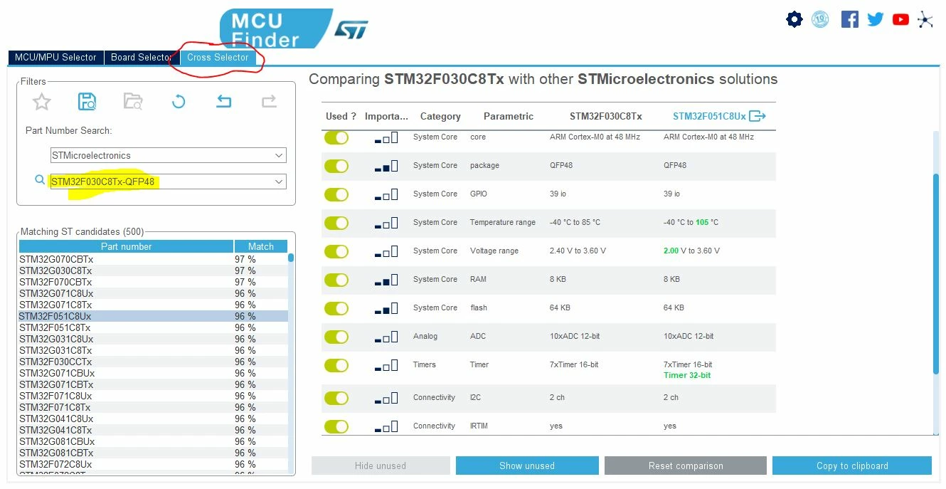

STM32F050C4T6A I want to use as a drop in replacement since I cannot find stock in the STM32F030C8T6 When I installed it in my board I use two I2C ports and they both work but the manual says there is only 1 I2C port. Am I ok to use this chip?

Hello
with MCUFinder you can easily find the closest match.
eg
