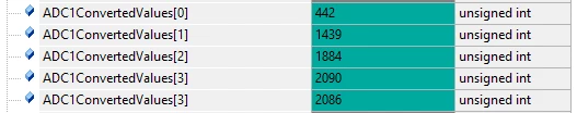

Hello All,
Hoping someone can help me understand the ADC DMA via ST's HAL. I haven't been able to locate the information I need to understand how it works or what I have read still doesn't give me what I need so if someone refers me to the proper doc I'll take a RTFM response if it clearly gives me the understanding I am looking for.
Essentially I have 4 ADC's (in 12 bit resolution mode) and I am trying capture that data and convert it (ie temp, moisture, ect..). Trying to understand how the API works for the DMA conversion and how my 4 ADC channels align in my assigned pointer. Below outlines what I currently have set up, and highlighted in red text is where my confusion is.

Debugger Watch result:

if (HAL_ADC_Start_DMA(&hadc, (uint32_t*)ADC1ConvertedValues,
1024
) != HAL_OK);
1024 is not correct, it should be 4 for you, I think.
STM32F7xx HAL Library Descriped as below:
* @brief Enables ADC DMA request after last transfer (Single-ADC mode) and enables ADC peripheral
* @param hadc: pointer to a ADC_HandleTypeDef structure that contains
* the configuration information for the specified ADC.
* @param pData: The destination Buffer address.
* @param Length:
The length of data to be transferred from ADC peripheral to memory.
* @retval HAL status
HAL_StatusTypeDef HAL_ADC_Start_DMA(ADC_HandleTypeDef* hadc, uint32_t* pData, uint32_t Length);
Read 4-ADC-Channel to memnory
static uint16_t adc_buffer[4];
hadc1.Init.NbrOfConversion == 4
if(HAL_ADC_Start_DMA(&hadc1, (uint32_t*)&adc_buffer, hadc1.Init.NbrOfConversion) != HAL_OK);
HAL_Delay(500);
HAL_ADC_Stop_DMA(&hadc1);
