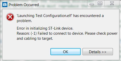

I installed the Atollic TrueSTUDIO IDE for developing software for the STM32F303RE-Nucleo board, and have been trying to run the example file located in: STM32Cube_FW_F3_V1.4.0\Projects\STM32F303RE-Nucleo\Examples\GPIO\GPIO_IOToggle\TrueSTUDIO which I downloaded from the ST site. After opening the project in TrueSTUDIO and building it, I try to run it using the F11 key and I get the following console output:

However, I then get a pop-up saying:
I've been trying to debug this and I can't figure out what is causing this error, since the board is plugged in to the laptop via USB.

    Posted on February 02, 2016 at 19:33
    Hi Farah,
    sometimes I have the same problem, usually it can be solved by closing TrueStudio and reconnecting the board.
