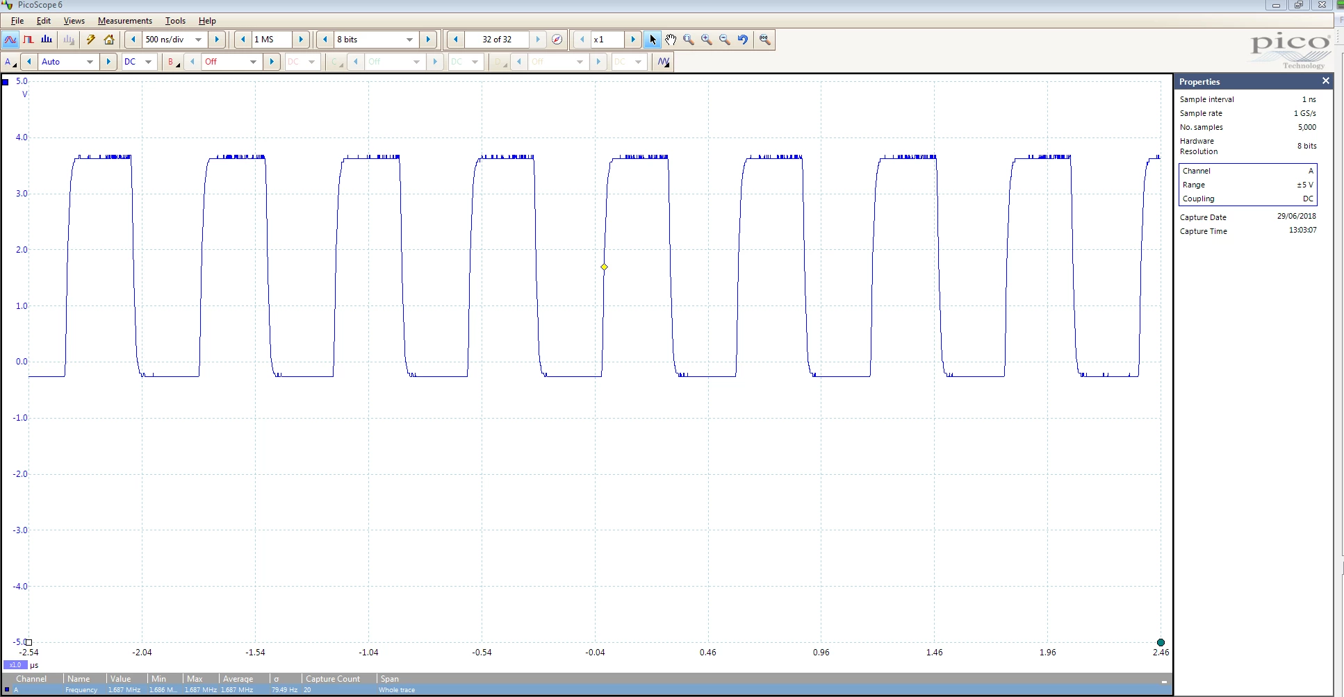

Hi everyone. I am using STM32F303RE and STM32L011 nucleo boards as a part of my experiment. I used STM32F303RE to generate PWM signal (in Interrupt mode) for 1MHz.
Clock Source - PLLCLK (8Mhz * 9 = 72 MHz).
Timer Period = 71
PWM pulse = 35 (for 50% duty cycle)
I used picoscope to measure the frequency. You can see the image below.

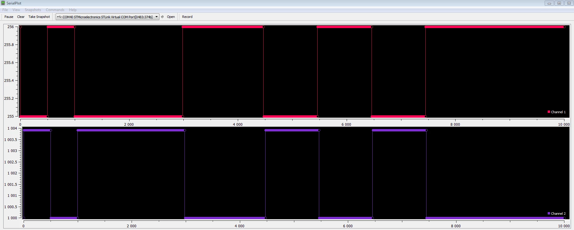

Now, i set up the STM32L011 in input capture mode (interrupt mode) to capture this 1 MHz signal. It has 32MHz clock source. The input signal is divided by 8 ( sConfigIC.ICPrescaler = TIM_ICPSC_DIV8;)
In Interrupt mode, i used CCR register to get the captures done. I read it through UART in serial plot.
As you can see, the timer misses a count. I don't know the problem behind this but this always happens. The timer always misses a count. I tested with different signals but got the same result. Even tried PWM with STM32L011 and captured in another controller, but the result is the same.
Here is the capture_flag_function that i use to get the values

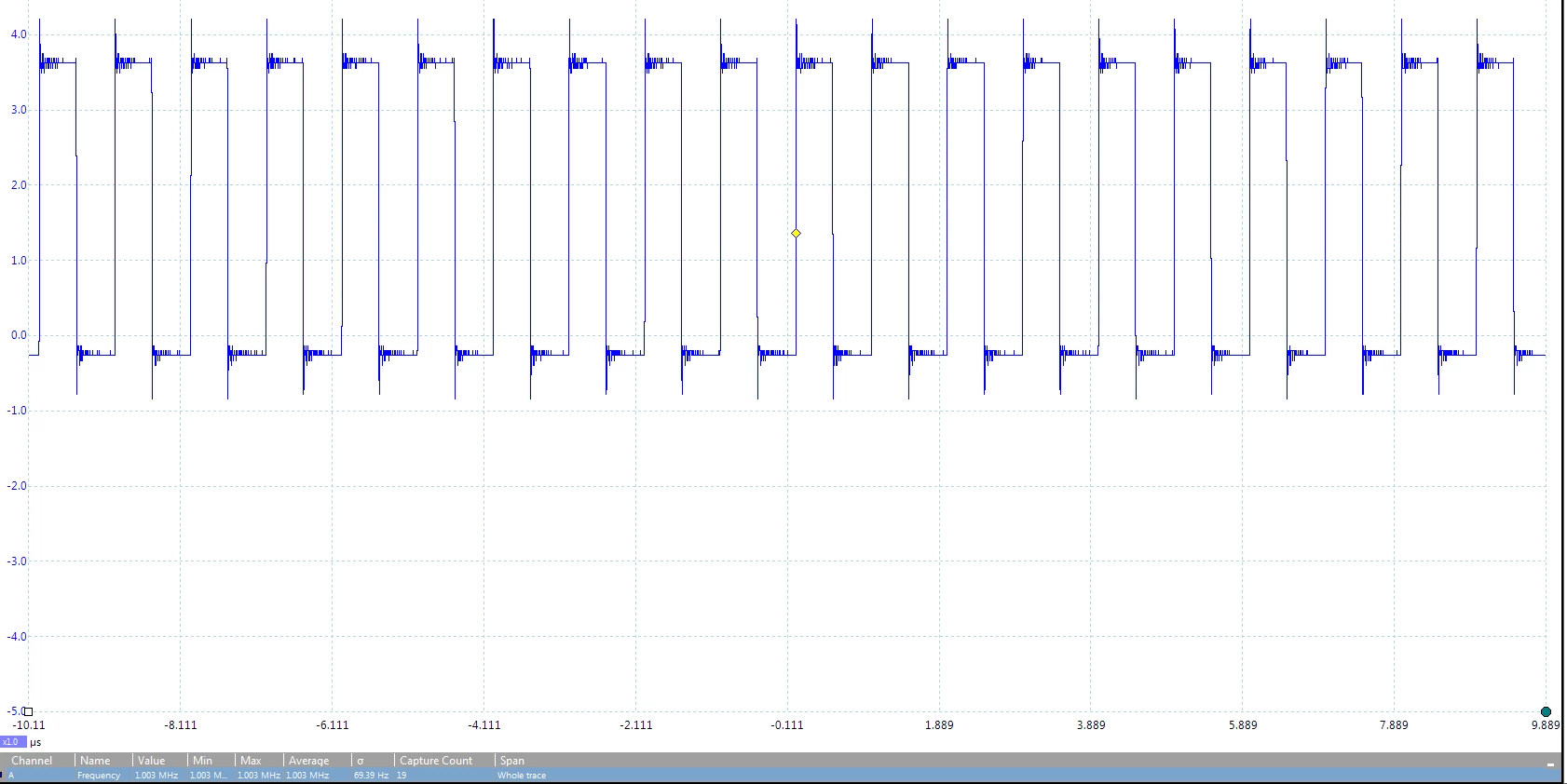

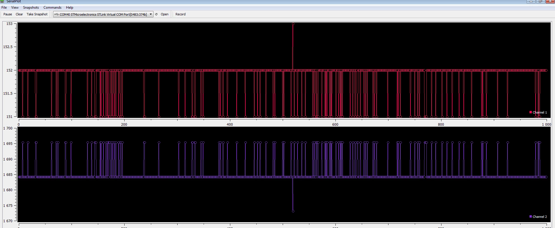

So, neglecting all the sarcasm, I wanted to know the problem faced because of the accuracy of the internal clocks. This occured when I tried to measure higher frequency. See the image below.
Now, the picoscope measurement of the same frequency.
As you can see, the counts are pretty much good but not accurate enough. There is always count miss of 1-2, whether it is a lower frequency or higher.

what is this picture serialPlot ?,
from a uart pin ?  what is the bottom axis time trace  in mSeconds ? what is the left axis ?
