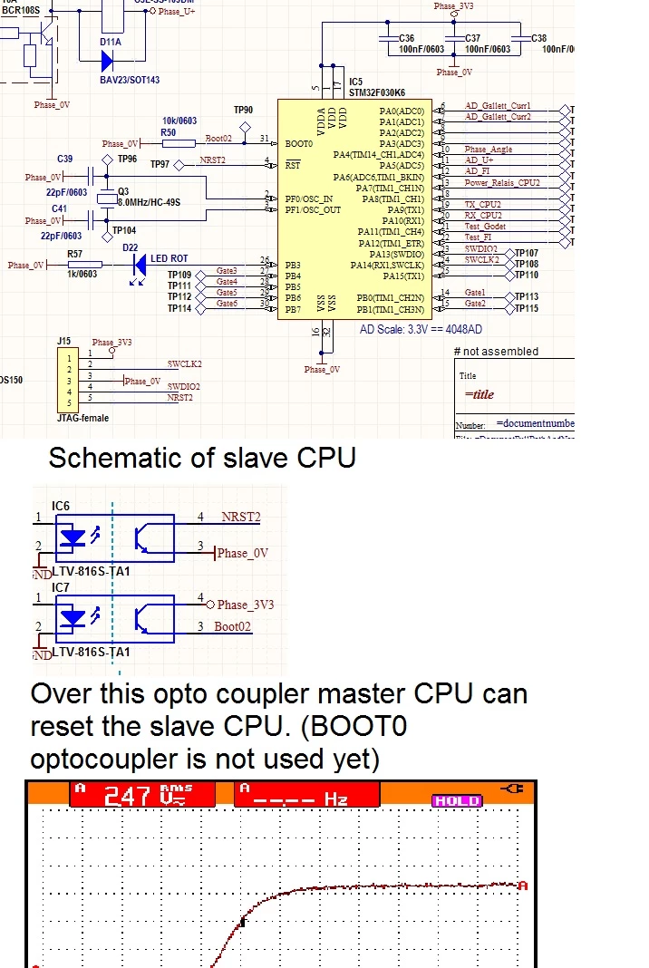

Dear all
I use a master uP (STM32F072R8) and a slave uP (STM32F030K6) The slave processor is in AC main voltage and the main processor is galavanic isolated from main voltage.
The main processor can reset the slave processor by a opto coupler. (see attachement)
The opto coupler can reset the slave processor. After power up the main processor hold the slave processor for 2s in Reset state. After this 2s starts slave also. This is the NRESET signal on Slave processor, when master processor starts the slave processor.
I tried:
- 47nF capacitor from NRST Pin to Minus of slave processor
- 10k pullup from NRST to 3.3V power supply of processor
- mechanical Reset Switch parallel to Opto Coupler
Result:
If master processor don't reset slave the slave processor start up allways. (Slave processor start up with rising power supply)
With mechanical Reset sometimes (30% of button clicks) the slave processor starts up.
With optocoupler (like schematic) slave processor never start up. Also pullup and/or 47nF capacitor don't help.
BOOT0 signal is perfect. I cannot see any spikes.
Power supply of slave CPU is also perfect. This voltage is provided by linear DCDC Converter NCP1117-3.3V.
For CPU schematic see attachement.

Posted on September 14, 2015 at 17:37
Dear all
It was SW problem. There was a debug LED in the evalboard, which no in the final hardware sometimes slave CPU set int SW download mode. And then no uP can run.
